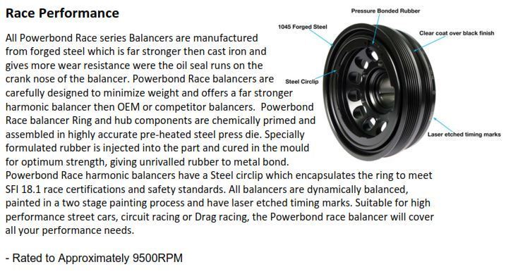

PowerBond Race Series is the best LS balancer for the money. ATI and IV are expensive and not worth the extra coin for most applications. Use the ARP crank bolt and have a shop tell you how they will apply the ARP lube and proper torque foot pounds (wanna say it's 235 ft. lbs.) so that you know, that they know, what they are doing.
A good shop who knows what they are doing can do this for the $700 range, if you supply the parts. Look for coupon codes at AutoZone.com and you actually buy one there, and have it drop shipped directly from Dayco in Memphis to your door.

The PowerBond Race Series balancer ought to be what GM hung on the Corvette from the beginning. Even their standard replacement balancer is signifigantly superior to the GM balancer. For most Corvette applications the PowerBond Race Series is the best bang for the dollar. Ditch the GM TTY crank bolt and get an ARP crank bolt kit and don't worry about the balancer any more.
