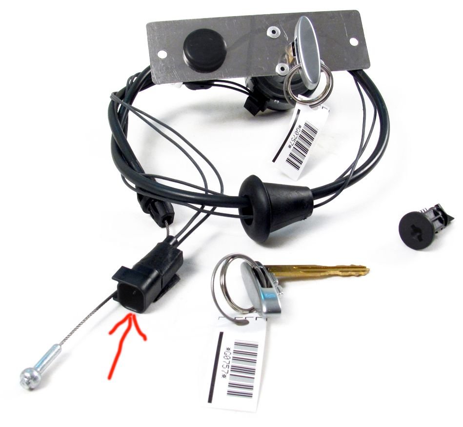

Or problem with the interior relay switch in the cylinder Mech.
Hence the key cylinder part to unlock the latch is a cable part to latch, but there is a relay latch in the cylinder mech to send the signal back to the BCM as well (for key programming).
https://www.smcautoparts.com/2586547...472-axx001.htm
So to check the relay, disconnect the electric connector, put a multi meter set to ohms on the connector prongs, and cycle the key all the way to see if you get a ohm reading on the wires/relay. If you do, the problem is not at the cyclinder connector/wires, but up line in the wiring instead.
Also to point out, if the car is an export (BCM set to anything but USA), you can not use the rear key latch to get the car into to fob relearn mode. You have to use a tech II to get the car into relearn mode using SPS security programming, and will have a 10 min wait timer as well.
Note in a usa car, Tech II can be used without needing to use SPS, and there is no wait timer. Better yet, you don't have to play the long procedure game having to program fobs in one at a time in the correct order, and you can learn a fob into any RCDLR programming position direct replacement instead. Hence if you are programming a replacement fob back into RCDLR position one, you program it into position one directly, and the fob is postion 2,3,4 stay programmed into their postions without having to be relearned. Same goes for it the new fob needs to be programmed into say slot 2, and it a direct program without having to reprogram the rest of the fobs back in.
If the car goes into fob relearn mode, but does not see the fob in the glove box slot to program it in, bank that the glove box slot antenna fell out of its keeper and you will need to clip it back in.
Antenna is #12 and snaps into into the side slot of #13

^^Right. But first I'd get the simple part out of the way and make sure this connector has something plugged into it.

Agreed, and if the female connector is connected to the male connector, disconnect it, put a ohm meter on the pin ends, and make sure that you get a ohm reading when you turn the key all the way.
If you do, then clean both male and remale connector, reconnect the connector and see if you can get the car in to fob mode using the key.
If you don't get an ohm reading with the key turned all the way over, then the assembly can be pulled apart to fix the contactor points.
The alternative is to buy a new cylinder assembly, take it a lock smith to have the cylinder re-pinned to match your Vin number key, and then install the new one back in place.
