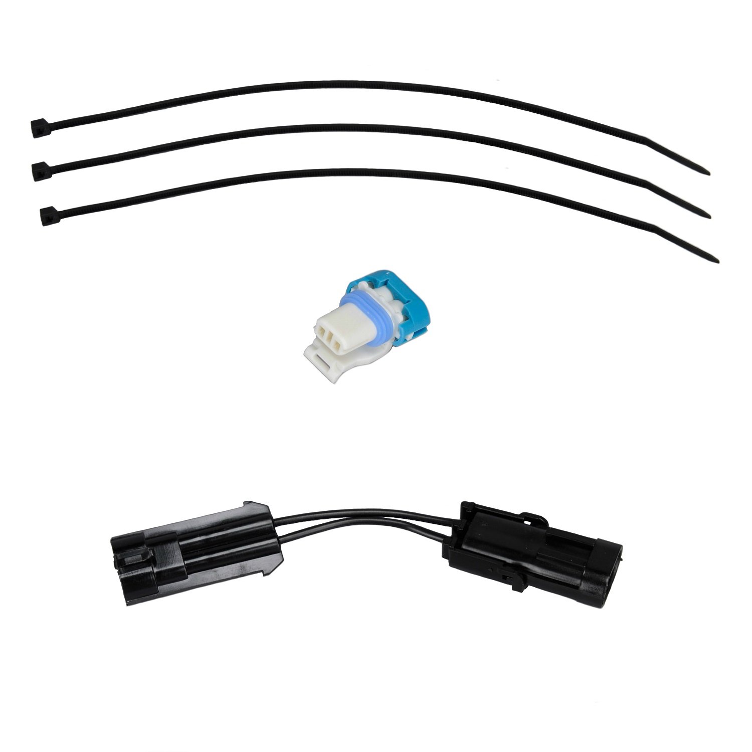

You need to get yourself a CAGS Skip Shift Eliminator $19.95. Only takes a few minutes to install. I have a brand new one if you're interested. I have never been able to get my C6 to do the 1st to 4th skip shift, so I never installed it. Figured previous owner must of done the mod. The 1st to 4th light still comes on tho.

No, since the CAGS Skip Shift Eliminator $19.95 is just a resistor as well, and was needed on the C5 since the fuse in the engine bay was being used for more than just the Cags silinoid in the trans, and required that that on the C5, the reistor had to be placed at the trans.
So on the C5, you need this since the 2.2Kohm resistor had to be placed right before the cags solenoid on the trans, since back up line at the fuse box, the 10amp fuse was feeding more that the cags solenoid alone.
On the C6, Fuse #10 is only being used for the cage circuit feed wire back to the solenoid only, so the resistor can be placed in the engine fuse box, isntead of having to get under the car to install it on the trans with a plug type device shown above isntead.
https://xse.com/leres/z06/cags.html
Or as stated, if your soldering skills suck, then you can buy factory produced 2.2k ohm fuses that looks like a factory 10 amp fuse isntead.
Truth is, I still have my 2.2K fuse in my car from pre-tune day and have just not go around to swapping it out yet with a standard 10 amp fuse instead. Hence will come a time that someone without a tune may need it that I run across in person, and will just swap fuses with them to solve there 104 cags shift problem then.
