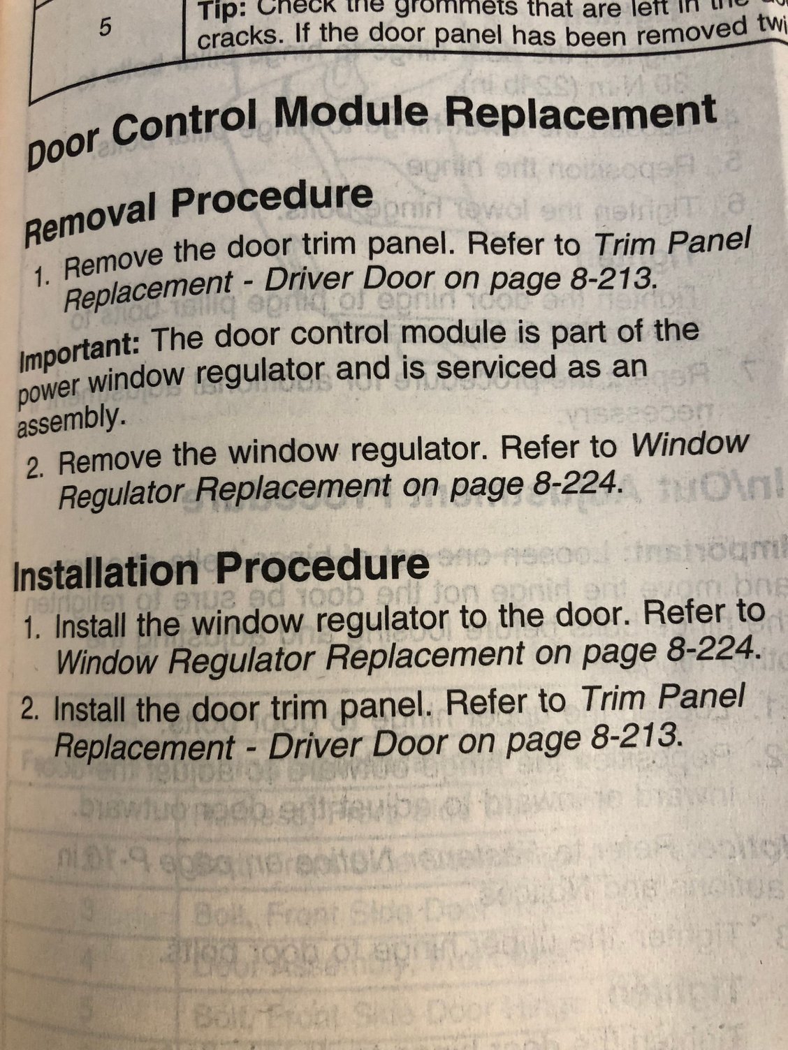

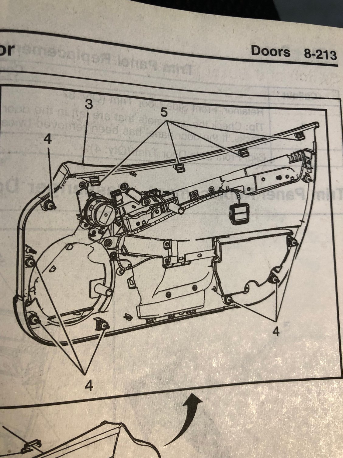

This is getting more confusing as I go. Diagnostics say the DDM is bad. But I can't find a part number for a DDM. In digging into the service manual it looks like the DDM is actually part of the window regulator. (see the pics) Can anyone confirm that is the case? You have to buy a new window regulator in order to get the DDM?
From the Service Manual
Drivers Side Door Panel
Window Regulator Kit
To Drivers door
Tony pop your inside button off and disconnect it and add 12 volts to the blue wire(I think) and see if the lock in the B Pillar works,if not that would be your problem..Maybe?

They charged me $120 for the diagnostic scan. They did confirm a bad DDM, but as I mentioned before that DDM is part of the window regulator. Cost $280 on Amazon. I went ahead and ordered it and pulled the old one out. Less than 1 hour with help from a YouTube video. Now if I can just get it all back together when the new part comes in. 😄
PS, this was the same window module the same dealership replaced 2 years ago when the window motor went bad. $800 then. Ouch!
