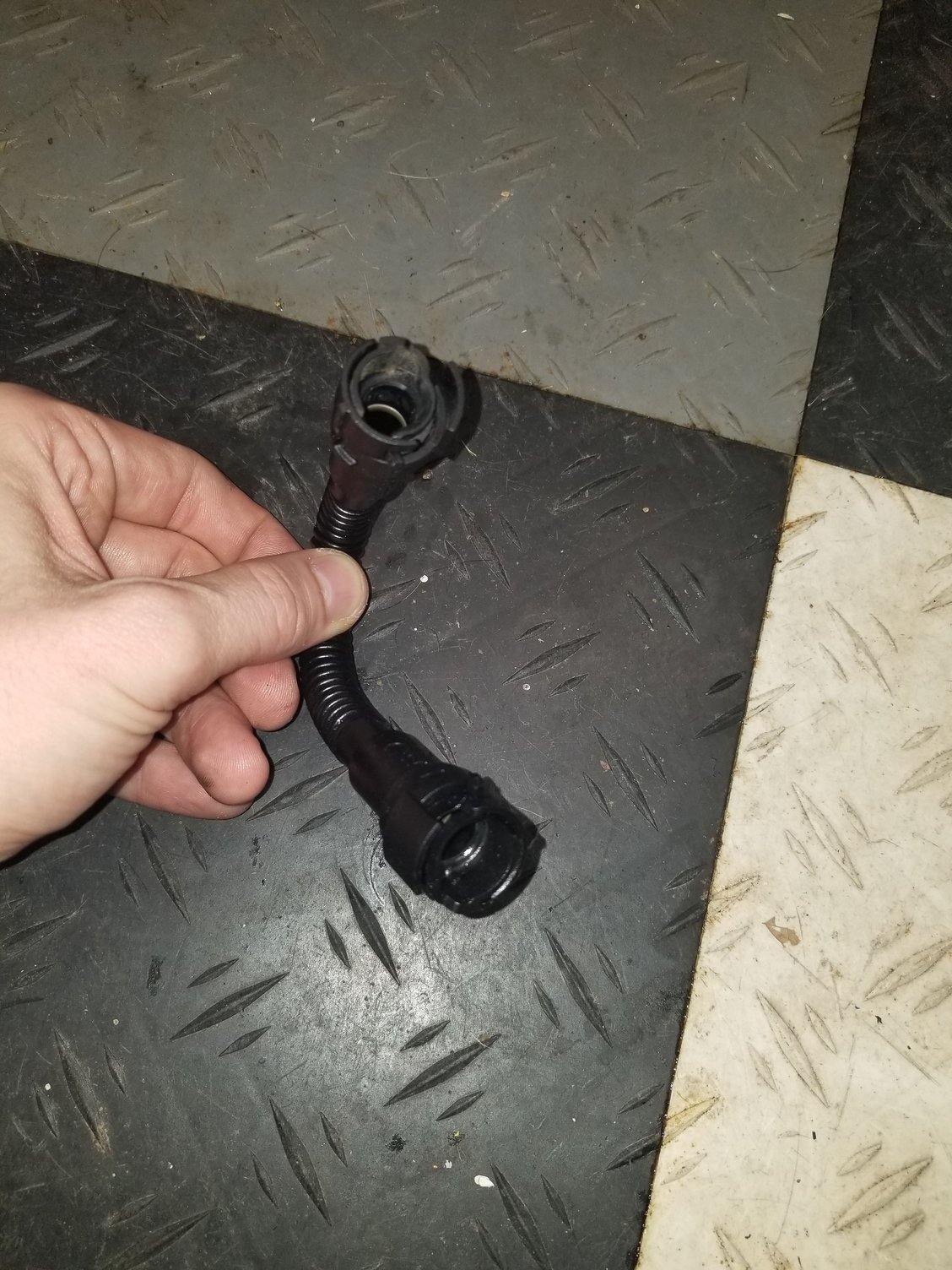

Sorry, I should have been more clear. It's not a barb it's the quick connect fittings that you remove the u tube from on the manifold and valley. The 3/8" slides over but is not secure.

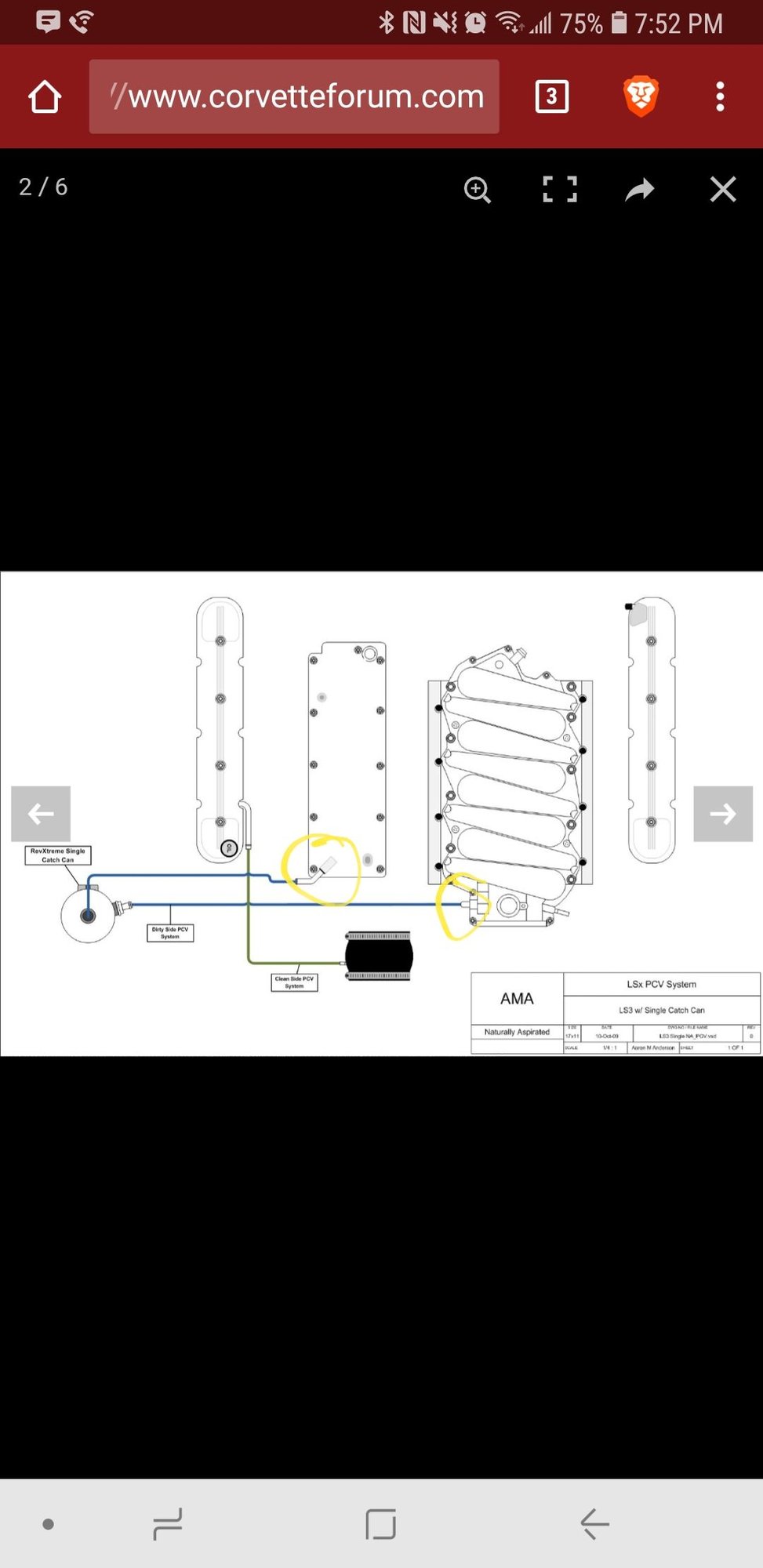

It is a PCV catch can, but the fitting issue isn't on the can... it's on the car. I already have 3/8" barbed fittings on the can.
They are the circled fittings on your diagram below and are pictured below. The u shaped connector came off of these fittings.

OP, I pulled the ends off a spare pcv line I had and shoved it in the fuel hose to make a nice fit over those barbs. I'm sure they can be purchased separately (I've seen them but my google-fu is weak this morning).
