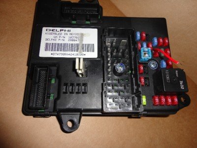

The GM land bus fuse is the bigger blue 20 amp fuse dead center of the BCM.
So OBD II port goes directly to the BCM, and if you have a problem with the scanner not connecting to the BCM, then you have a problem with either the OBD II port, the BCM connector, or the BCM itself.
As for your problem, start with disconnecting the battery for a few mins, reconnect it to hard reset all the modules, then pull the codes and list them.
Note, don't forget to reindex the windows when you reconnect the battery.

and yes I will do the hard reset by pulling the battery cable now. Thanks for the pic of where the fuse is. If the hard reset doesn’t work I will try the fuses and yes I learned about re index the windows lol
