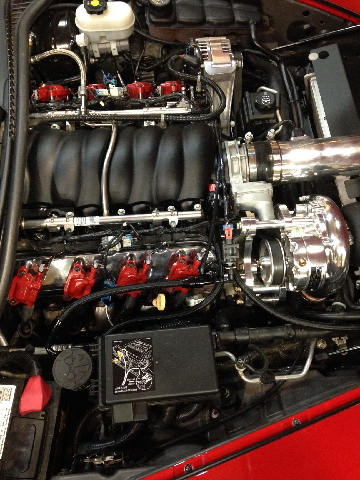

This is a VERY different setup than what you are trying to do, but when I set up my MM catch can I placed it between the battery and the fusebox. It fits nicely there and out of the way, albeit lines need to be much longer. Just another idea for you.
Old Jul 10, 2018 | 08:34 PM
Elijah71's Avatar
Elijah71
Joined: Jan 2015
Posts: 809
Likes: 101
From: MD
I've done the same as blindspot. Mounted it between the battery and fusebox. I used the battery bolt that secures the battery to also secure the bracket.
