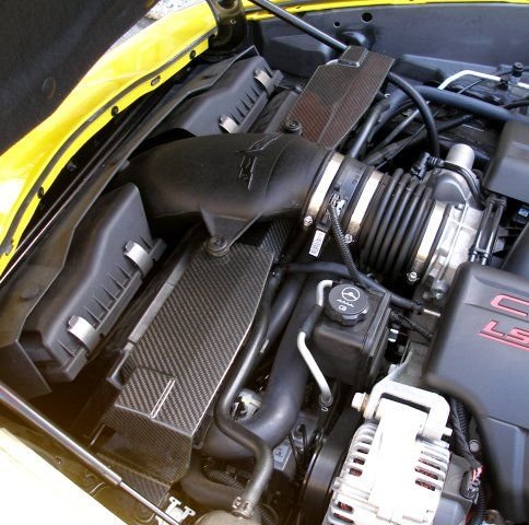

Throttle body is a bit different. LS2 is bottom right, LS3 is middle right. Notice the location of the electrical connections.
The intake manifolds are different. Look right behind the throttle body flange
The MAF is different.
LS2 MAF you can see connected to the air bridge over the radiator and before the accordion style rubber tube.
The LS3 and LS7 MAFs are built into the airbridge. You can see it plugged into the airbridge just before the accordion style rubber hose.

Thank you. Pictures helps a lot.
