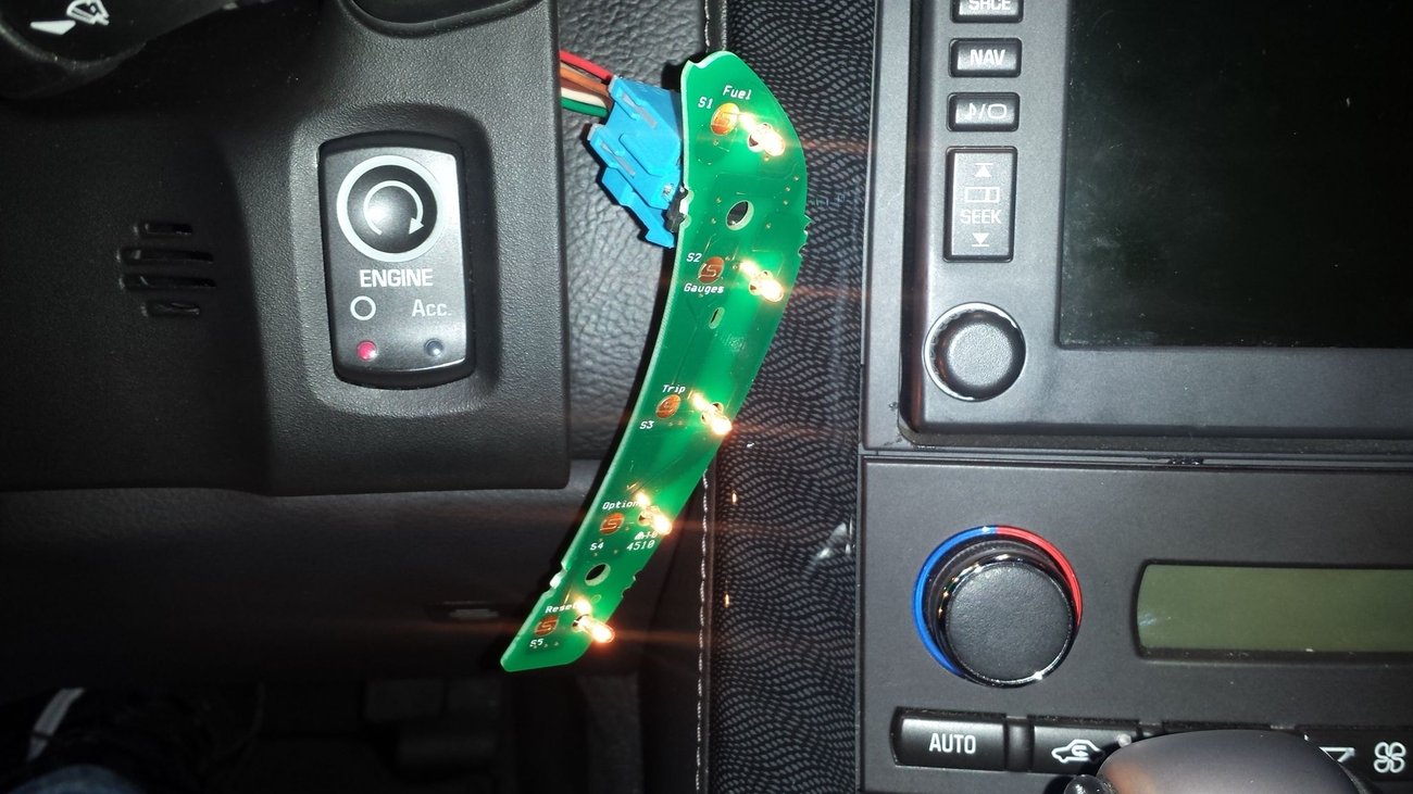

If only one is light, then the bulb in that side button's burned out on the board.
The button is easy to remove and pull apart to get to the light on the board, and will just need to solder a new bulb back into the button.
The #7219 bulb used in the dash pods and such is going to be too large, so would need a smaller 12v micro bulb like the T1-1-4-12V-0 bulb isntead.
Hence smaller type bulb used on the door push button boards, then the larger #7219 bulbs used on the dash pad board isntead.
Attachment 48342589

The question is how to remove that panel ? Do you pry it from the front or do you have to go from the back of the panel ????

Dano to the rescue . . . again! Attachment 48331950

Okay I had to try: I pry a flathead screwdriver next to the plastic frame and it just popped out. Time 2 seconds
This is what it looks like after you pull it out. As you can see it is just a clip on. I did not continue because i did this in a parking lot. So I will do the rest when I am at home and will return and report with photos

It seems that the connections was lose. Wiggle the connections and the light went on.
