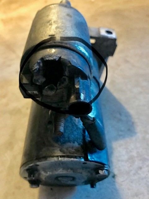

Had same issue, mine was starter solenoid had melted, probably due to my headers.Put a whole new starter on instead of just the solenoid. Not worth the price difference, new starter was $99 on Rock auto and solenoid was about $29.
