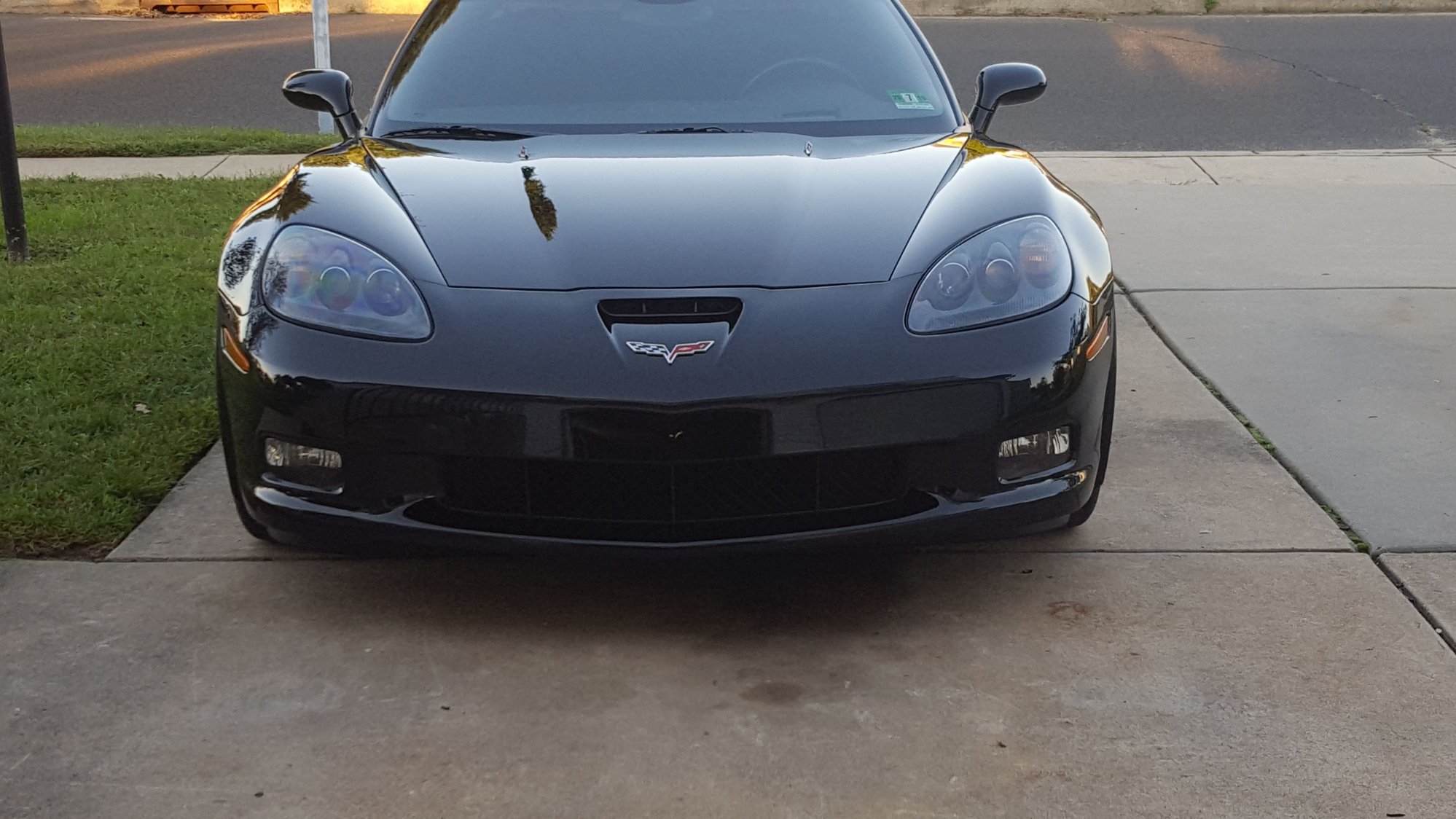

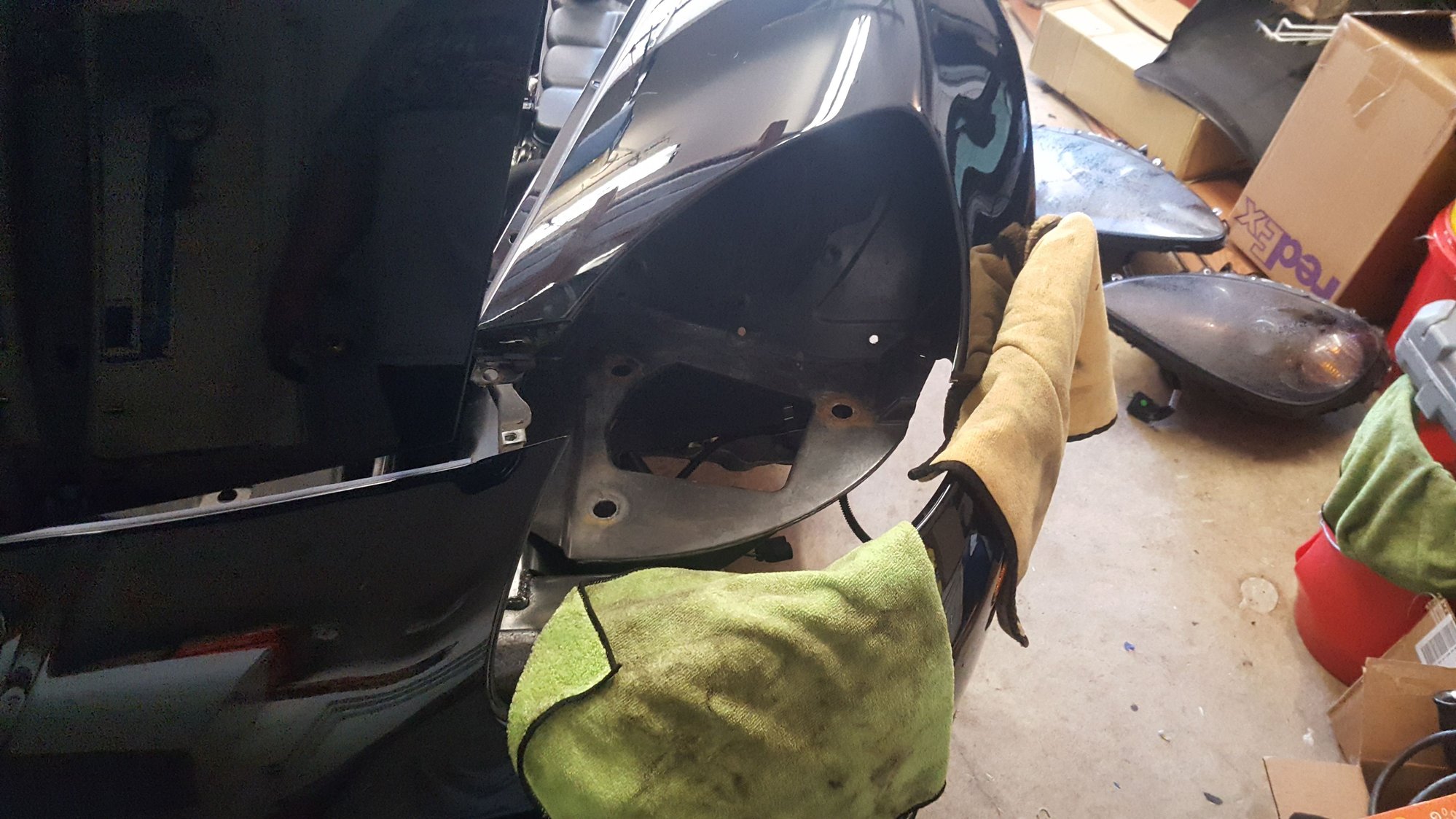

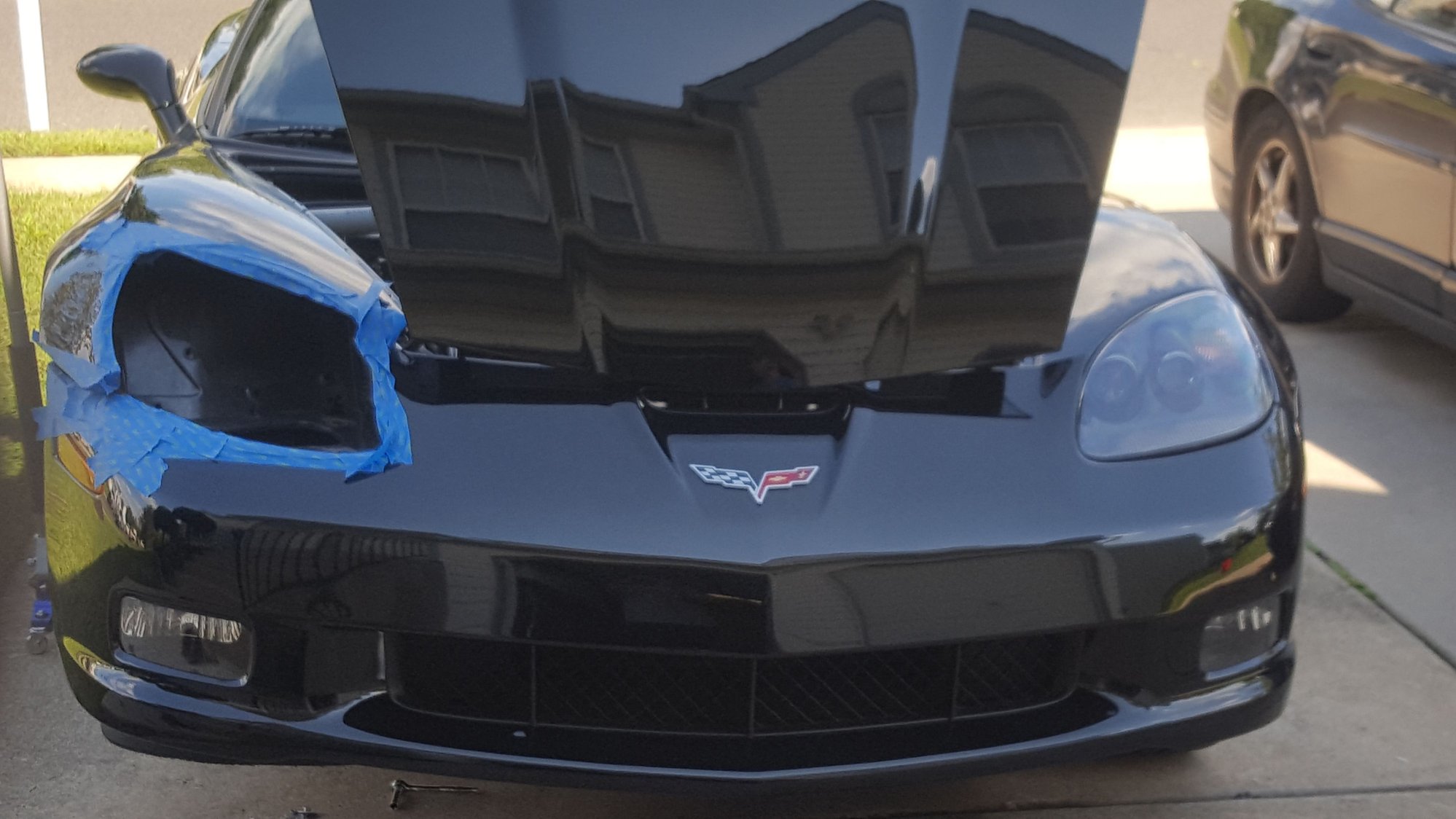

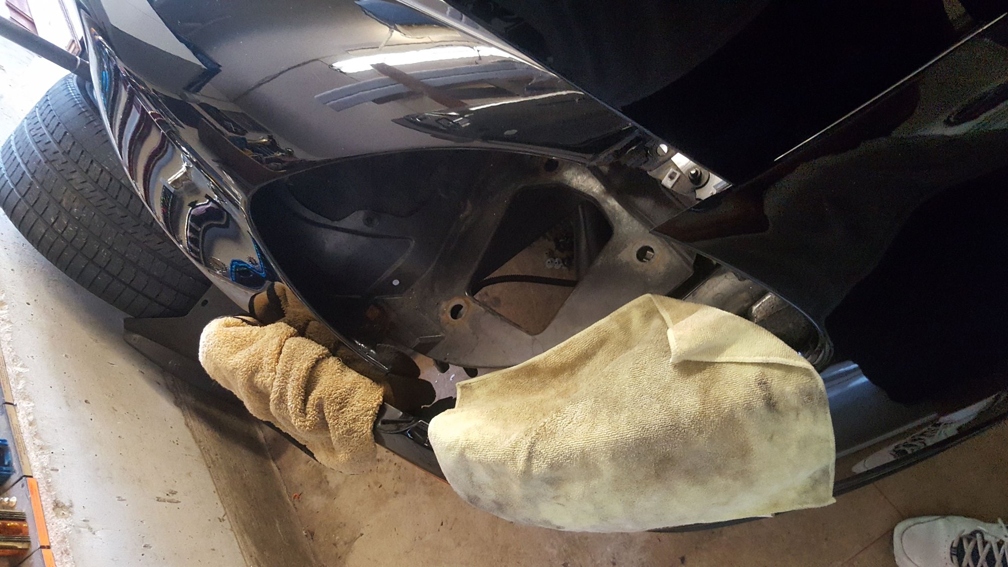

I bought my 08 Z in June and the headlights were tinted. The passenger's side had what looked like cracks so I guess it was covered with tint to hide it. I ordered a new set of lenses from RLSebring. I have to say...what a pain in the a$$. It was really easy to get the lights out but splitting those cases and getting the old sealer out..rough. I got everything done and pulled the Z out in the sun and noticed finger prints all over the black bezel on the passenger's side. I couldn't live with it so apart it came..it sat for 24 hours with the new sealer before I took it apart the second time..glad it's done..

Thank you. They were tinted with heavy vinyl. I peeled it off and that was the glue that was left behind.

They were tinted when I purchased the Z in June. The passenger's side lense had what looked like cracks. The drivers side was perfect. The tint was covering up the cracks until you turned the lights on. I didnt notice it prior to purchasing...my daughter pointed it out later that night. There was no fixing it. I just replaced both so everything matched. Z has 26k on it. The lights on the floor have the tint removed..thats glue all over them.
