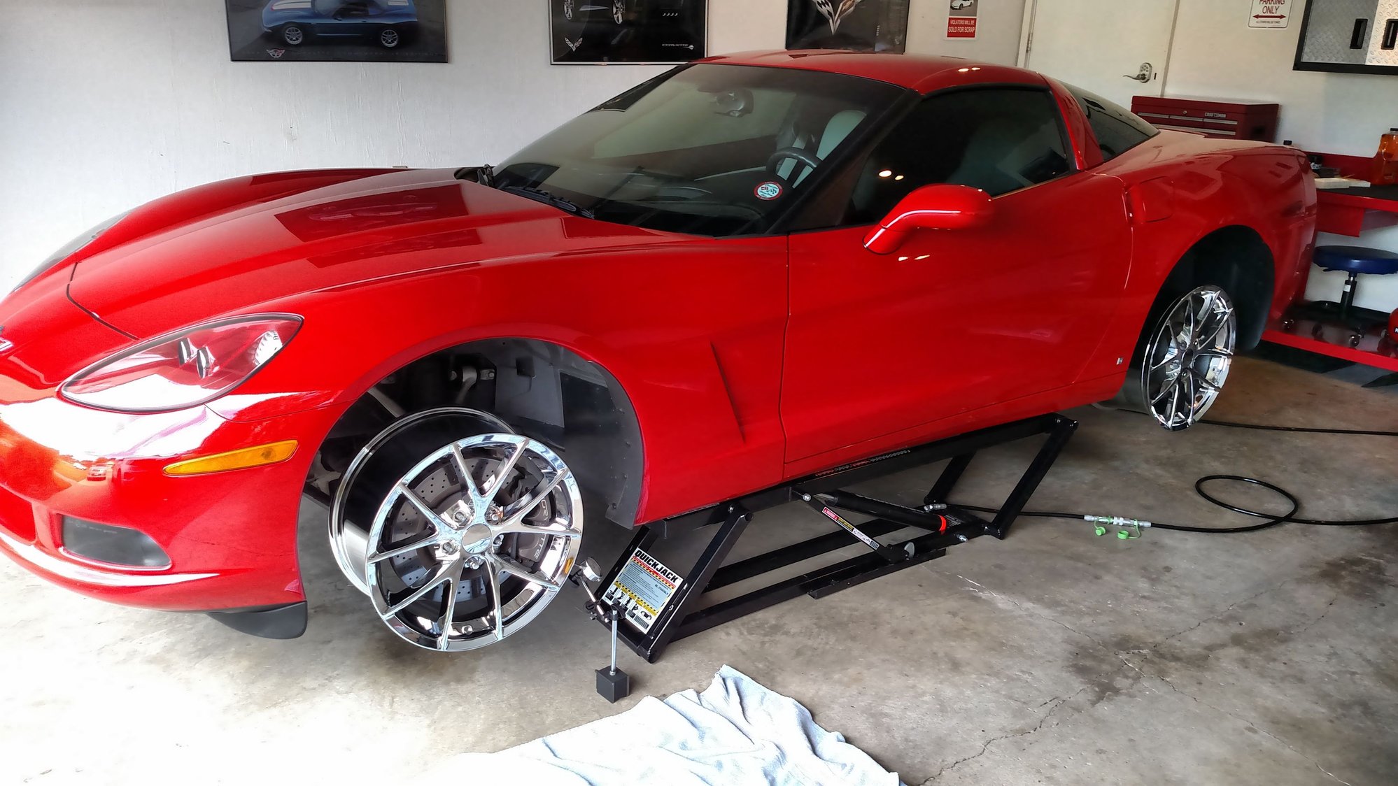

QuickJack.

Originally Posted by seijack
QuickJack.
This
