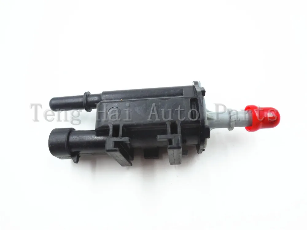

That is the connector for the OEM EVAP canister purge valve, and someone removed it from your car when they changed the valve out to one of the mods (and turned off the DTC that normally would be thrown with it not connected..
The oem valve looks like this,
And sits here just below the lower arrow and in front of the passenger valve cover,
