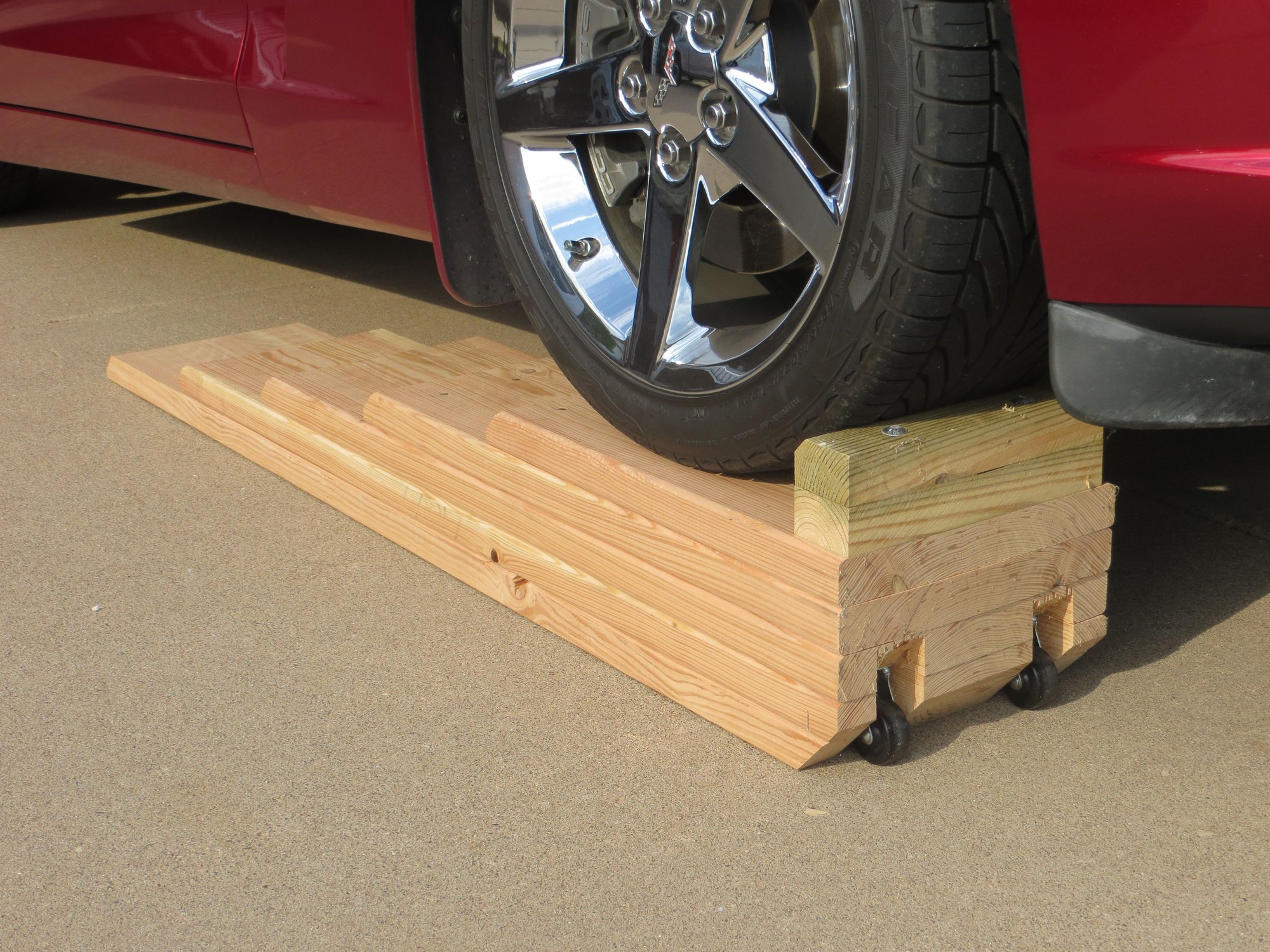

I went the 2x12 route as well. 5 layers gives me room underneath. Due to the slope of my driveway, this height also has my car level when the front is on the ramps and the rears on the driveway. They are a bit heavy so I added a couple of wheels to the ramps and roll them around like a wheelbarrow. Standing upright along the wall in the garage and they don't take up a lot of space.

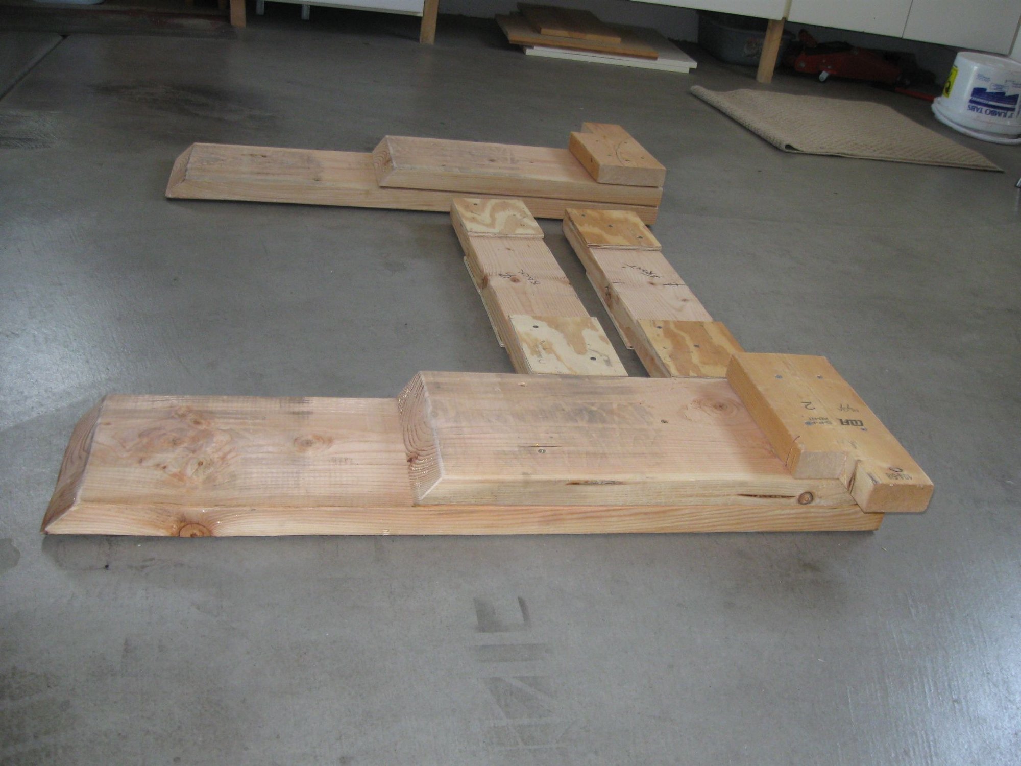

I built a pair of these for the front from 2 x 8's and use jackstands to make the car level when doing oil changes or trans fluid changes. Perfect height for me.
