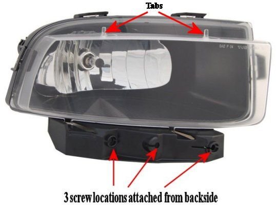

It's fairly simple to replace the fog lights with a few simple tools. push fastener removal tool or flat head screwdriver, 10 mm and 7 mm socket. refer to PDF for pics
1) remove the front wheel.
2) Remove the inner fender liner push fasteners (7) 4 along the outer edge and 3 just under the headlight access flapper
3) Remove the 10mm bolt under the front facia (1) Pull up on the fender flap to free the front inner fender liner
4) Remove the push fastener from the side to center air dam.
5) Once the inner liner is freed of the fasteners/bolt it can now be removed from the wheel side by pulling it out.
6) You can now access the (3) 7mm screws that hold the bottom of the fog light assembly.
7) Remove and replace the fog light in the reverse order. Notice that the top of the fog light assembly has 2 tabs that fit up into the bumper facia. Assure these are in place prior to installing the 3 bottom screws.

You can't easily do it, and if you could bake it off like a headlight lens, there are no fog light lens replacements that I know of, or it would be widely known on this forum
You could try polishing the lens with the same headlight restoration kits that are widely available.
The fog light lenses get beat up by sand etc. from the roads and highways. Replacing the whole assembly is the only way to get new lenses.
