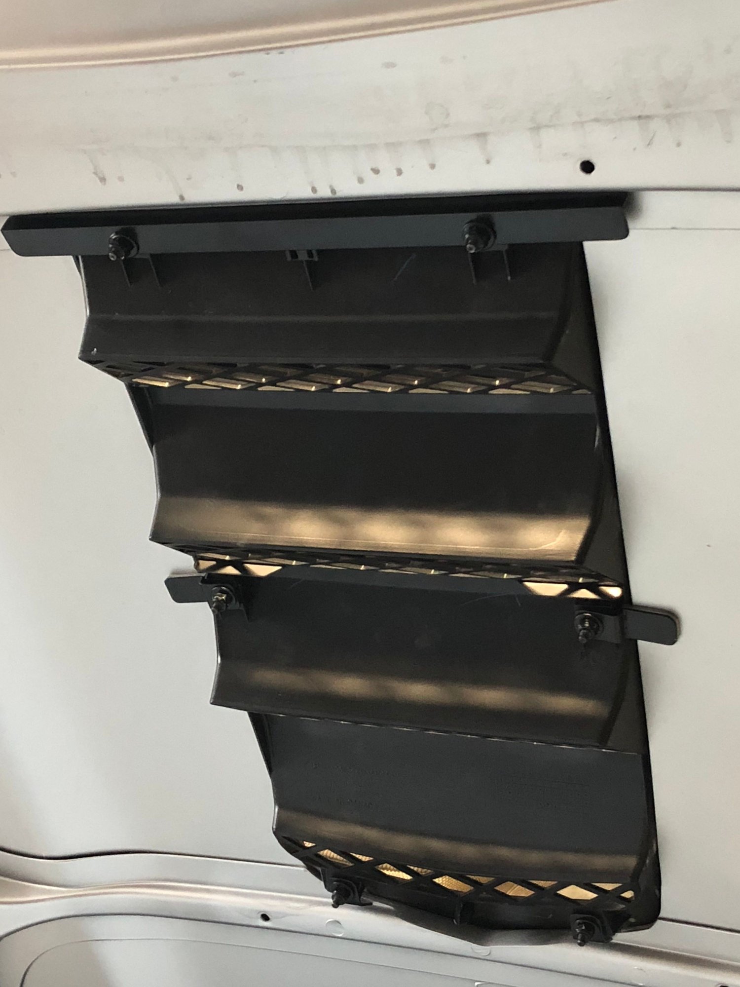

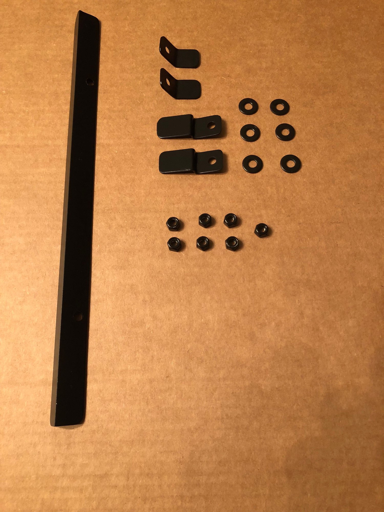

I'm presuming the stepped retainers are fabricated and did not come with the oem vent?
Old Nov 7, 2018 | 10:23 AM
itomh's Avatar
itomh
Joined: Dec 2016
Posts: 626
Likes: 118
From: Indianapolis
It doesn't come with the stepped retainers. I made mine using aluminum at local hardware store. I used a grinder to round the edges and 3M tape as a cushion/buffer between retainers and underside of hood and painted hardware. I thought it cleaned it up a bit. I also advise using nylon nuts so they don't vibrate loose. After cutting hood I rounded the cut edges a slight bit. It will smooth out any paint splinters and rough edges. It may not be necessary, but adds a nice finishing touch.
