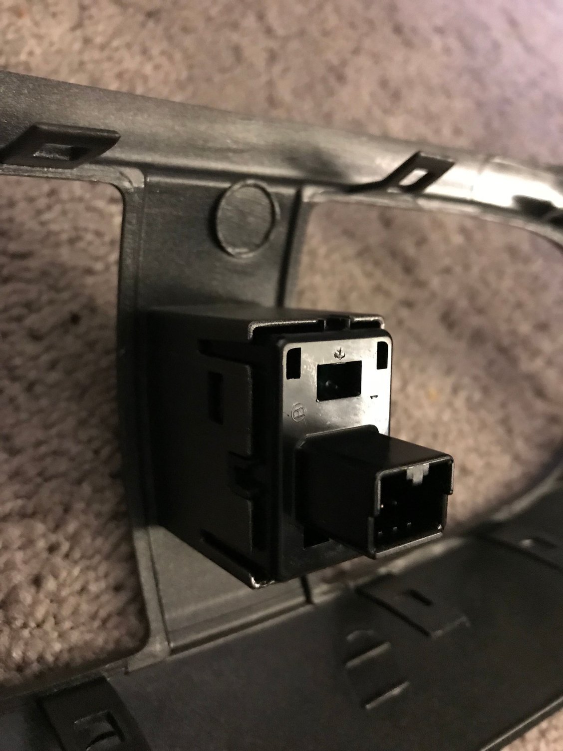

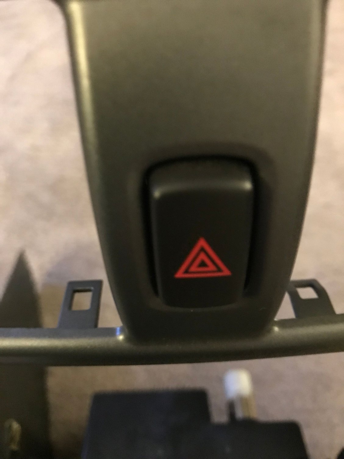

The hazard switch has tabs on each side, so get a thin and tiny flat screwdriver and put in between outer and inner housing as per pic and pull straight out

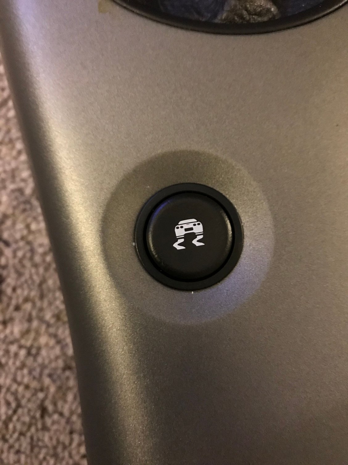

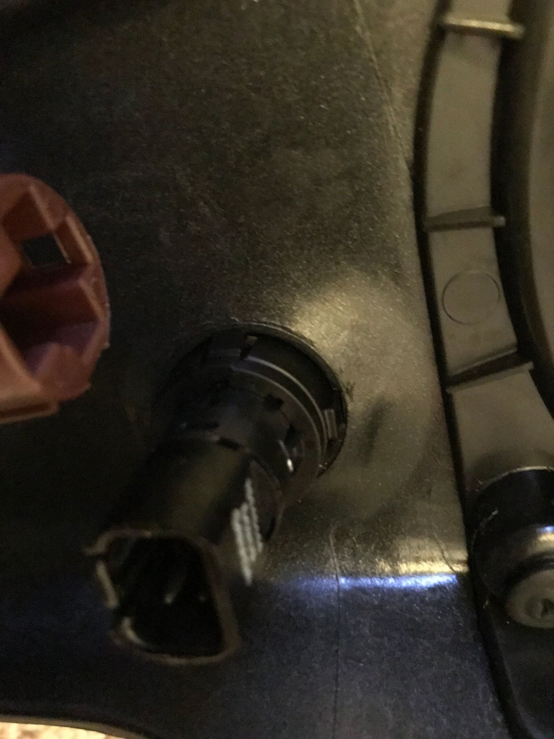

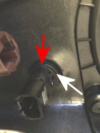

The Traction switch button has a tab (white arrow) that fits in a slot on the console. Rotate the switch and push in (red arrows) until the tab lines up you can push the switch out of the console.

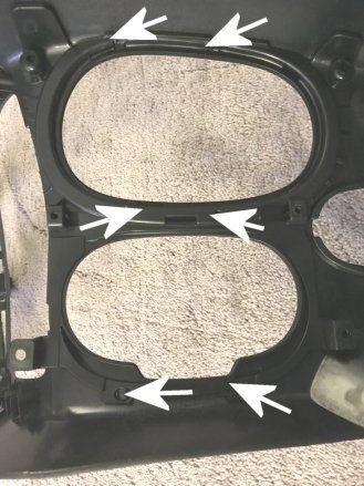

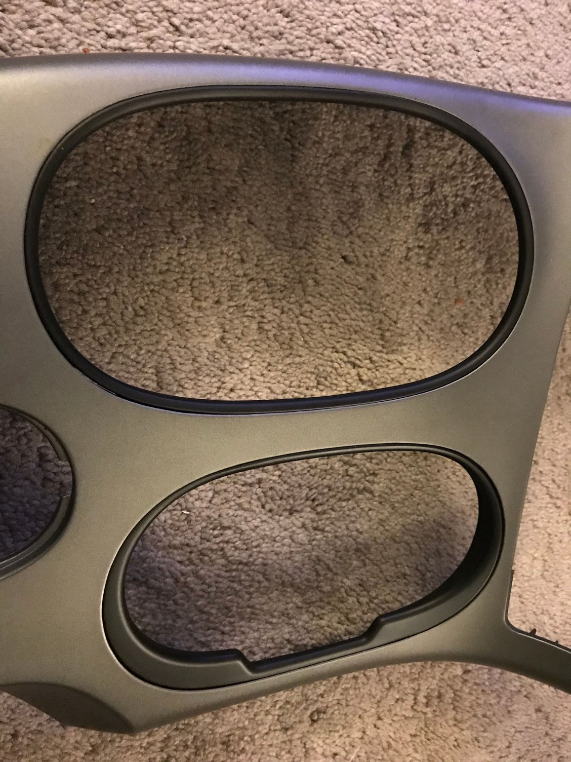

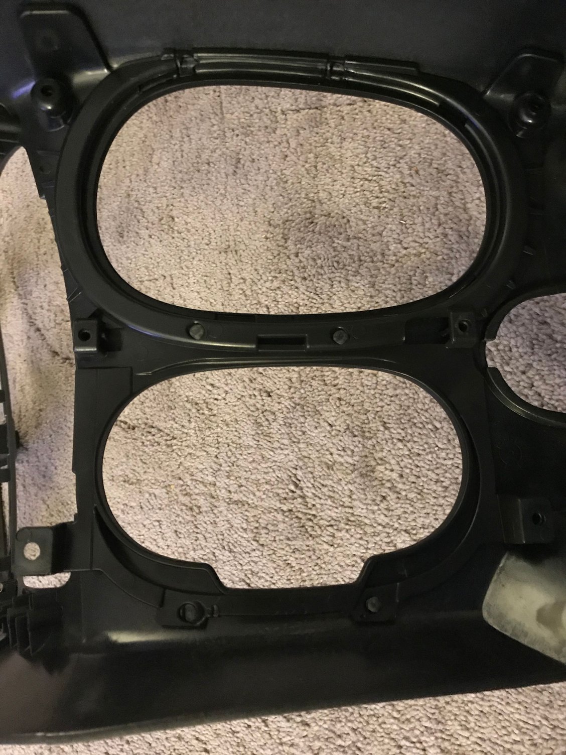

The trim pieces are held in with 4 screws, I believe, one on each corner. That will not release the trim pieces, as they are also held in tight to the console with melted rivet type plastic (white arrows). These have to be broken by prying up using a small srewdriver to release the trim pieces. The trim pieces can be replaced, and a hot glue gun can be used to reattach the trim pieces, along with the screws that were removed.
