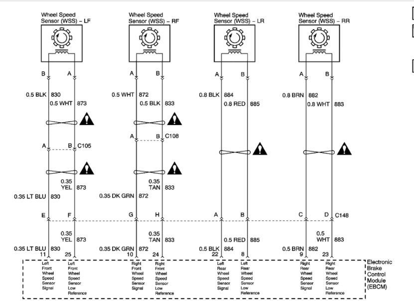

As far as the Traction light, there are a few things that can trigger this alarm.
1) A wheel speed sensor that either has a bad connector, or has failed. (Check the connector on all 4 wheels, and for any wires that may be broken or any corrosion inside the connector)
2) The fuse panel in the passenger compartment under the floor board. If a passenger was braking hard and pushing against the floor board to do so, it can dislofge the big blue connector slightly, thus causing all knids of weird things to happen, with traction alarm as one of those. You can check the blue connectors, remove, and check the pins, reconnect and use a spacer to prevent contact between the floor board and the fuse panel connectors. (see attached PDF file)
3) You can check the connector to the ECBM, which gets the signal from all the wheel speed sensors.
Try the easy stuff first, and hopefully the issue goes away.
