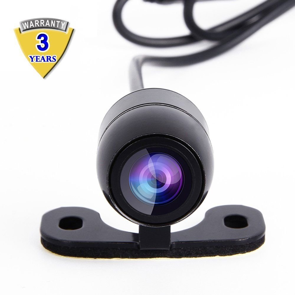

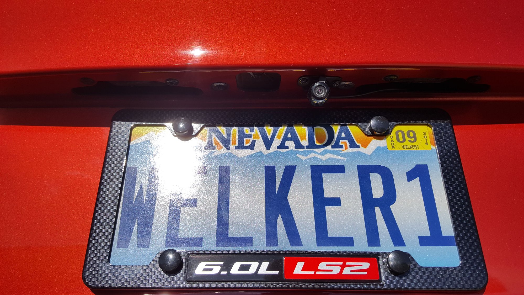

Got mine from Amazon as well. The mounting bracket is 'u' shaped an fit nicely around the button for the hatch while leaving the button operational (although I never use it).
