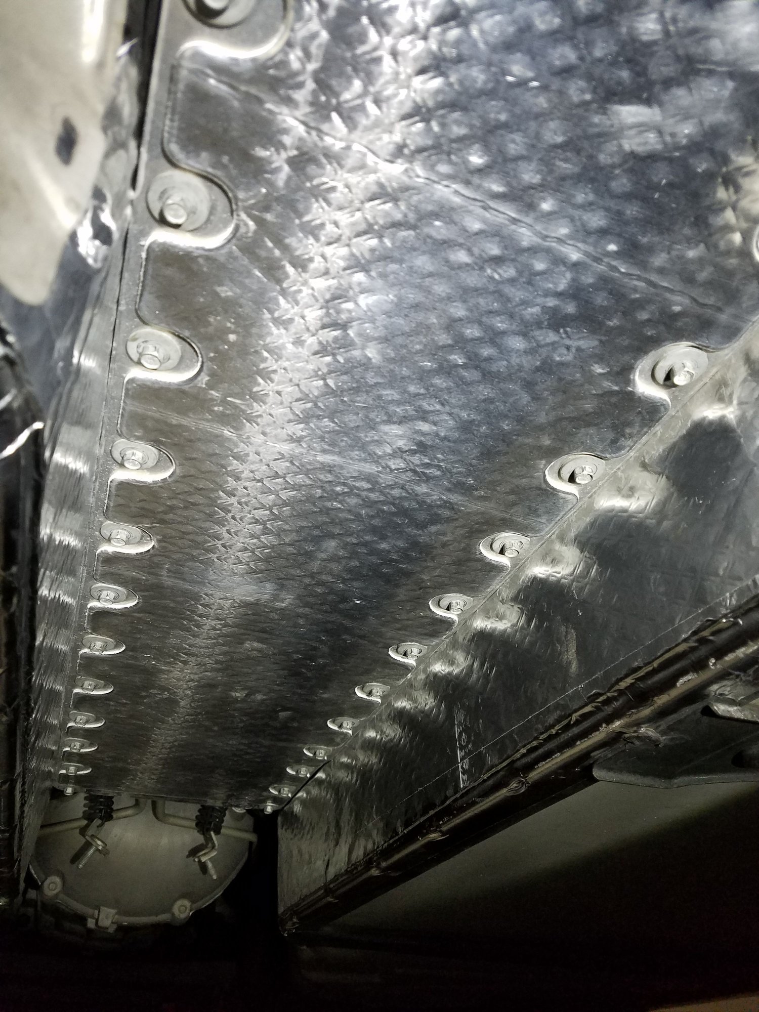

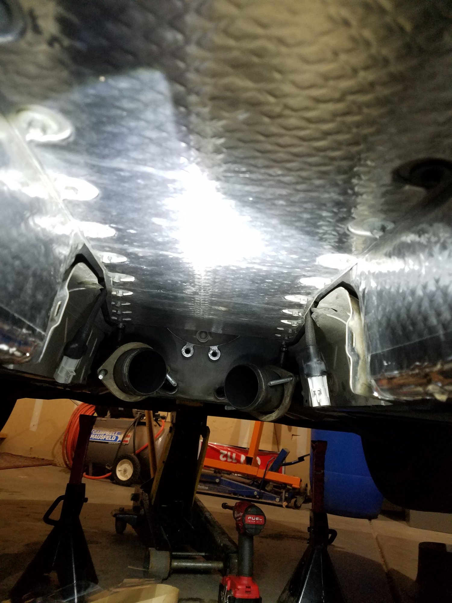

I agree with Not So Fast (NSF) i also did the Z-Cool tunnel insulation when i did my header install. Its the best mod/upgrade you can do on a C6. I got mine last month from Fred at Specialty Automotive Materials for 90 bucks shipped. Great price, great product, great guy/company
