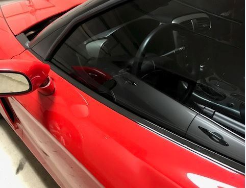

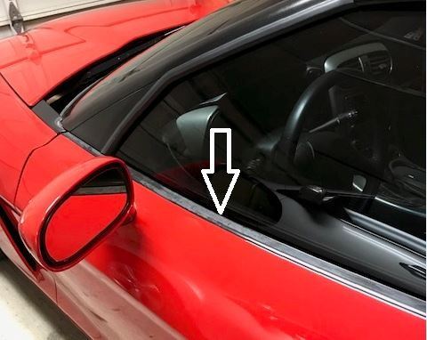

Howdy! I just picked up this C6 a few weeks ago (my first domestic v8 toy, and loving it so far...) but this faded weatherstripping is absolutely driving me nuts. I've been looking for a replacement for it but not having any luck. It's hard to tell on some of the OEM part sites which piece it is, if it's an interior or exterior piece on their diagrams. Has anyone had to do this or know what part # or have a link by any chance?

I tried plastidip for grins since I had some laying around with pretty poor results. Also tried back to black (well, same thing different brand) and that didn't do much.
I thought about painting but even after masking off for 30 minutes for plastidip, with a lot of funky angles I still had some small over spray, not sure i trust myself with real paint.

OK, I tried a "magic eraser". it's a real mild abrasive and had one lying around. Just taped off the paint on the lower section and gave it about a minute scrub on each side. Voila. Then, topped with the same trim shine (which didn't help before), now it looks 10x better.
Removing whatever that top layer is looks like the key. Will see how long it lasts or hold up if that was some sort of protective layer, but at the price of free 99....
