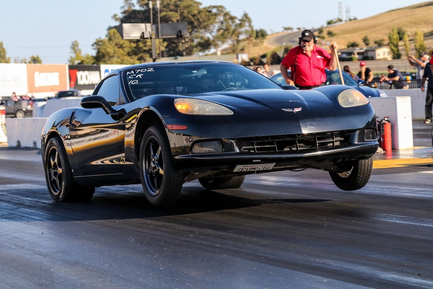

I've never dynoed the car but if I had to guess I'd say it's making around 600rwhp based on MPH and ET (9.933 is my best).
I've only ever had one issue with the stock setup, although it wasn't from the coupler itself. One time when I was doing an engine swap I noticed that the flexplate portion developed some hairline cracks which for all I know could have been there for months. Other than that I've never had a problem which is very surprising given how hard the car launches (my 60ft times are in the low to mid 1.3s).

Thanks for the excellent information and yes it is helpful. Your car looks great and leaves hard! What did the crankshaft thrust bearing look like in your old engine when you disassembled it? Just wondering if it showed any signs of excessive thrust damage.
