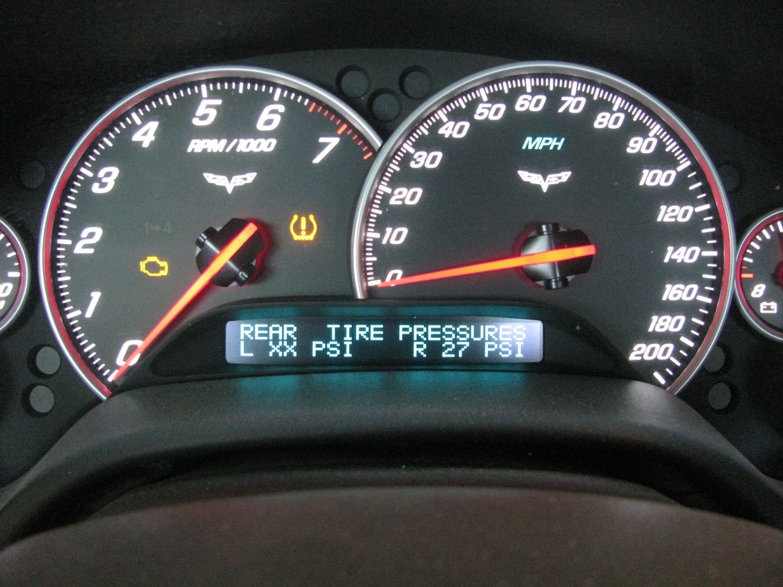

When the battery is failing you will get XX instead of a number.
You mean like this XX that's been showing up intermittently like a cancer that appears occasionally and then goes into remission for short periods during the last 8 years and 70K miles?
I've been ready to install new sensors so many times, but this one and only this one keeps coming back from the dead. I've also had every other possible DIC message about this sensor and I've learned to disregard them all. No other sensor has given any indication of failure yet.
BTW, the low pressure on the RR is due to cold temps (40's) last night. If it doesn't warm up soon, I'll have to add more air.
