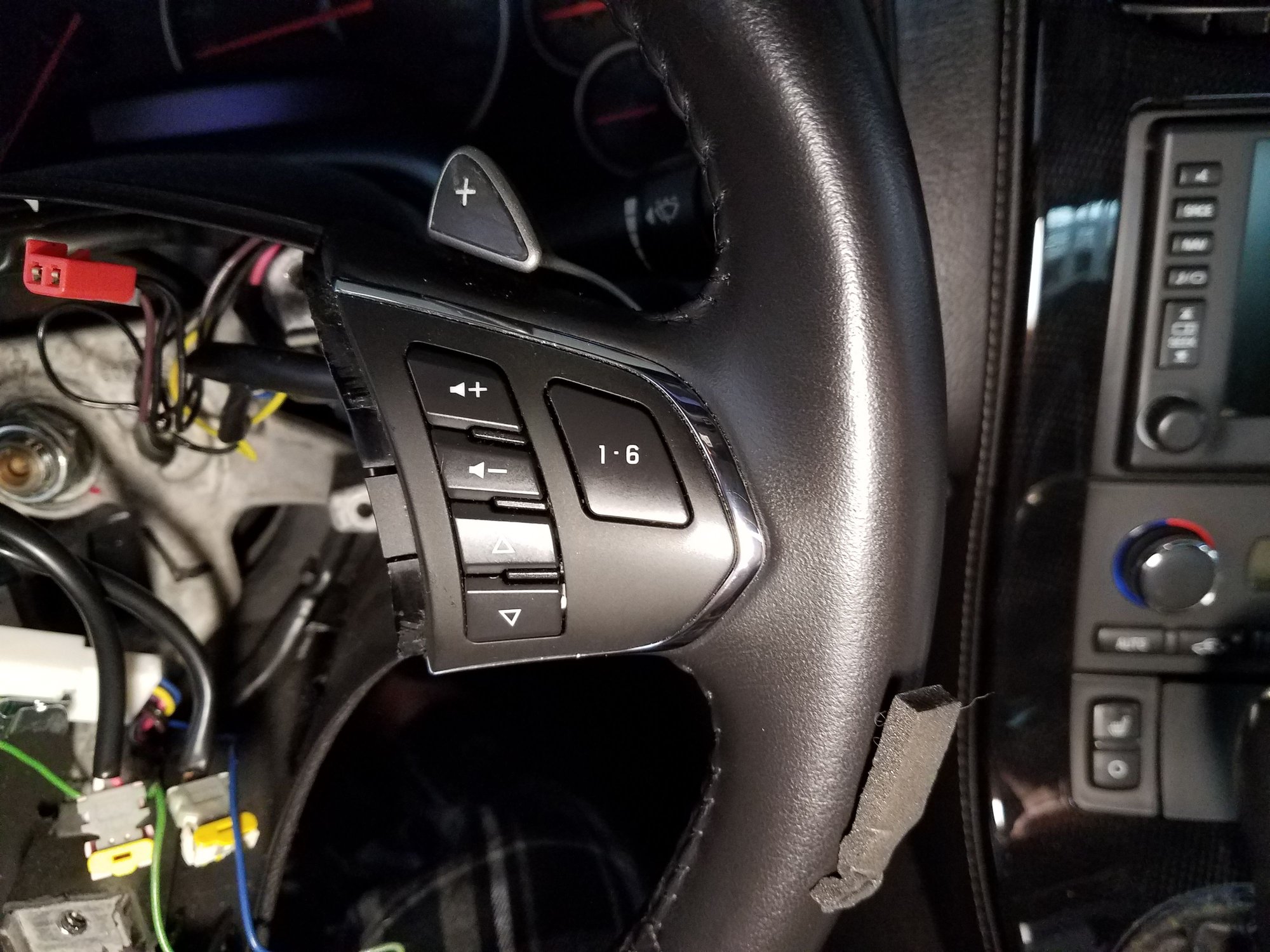

Can someone please tell me how to remove these steering wheel controls from the wheel?

The cover around the buttons( the black part) comes up (it’s sticky glued on) and there is a little hex screw underneath.

Yeah, just like Jabcat said, the black cover is sticky glued down and it just takes light steady pressure on it to remove it. Once the cover is removed, there is a chromed plastic part that the switches/buttons are fastened into that is easily removed with two little torx headed screws. The black plastic covers will re-adhere if kept clean.
You can also use a hair dryer to warm the adhesive.....makes it easier to remove.

I replaced the steering wheel and did not have a Bluetooth radio before. When I got the steering wheel it just came with the Bluetooth wires hanging like the last guy just cut the wires before he sent it to me.
Now I'm installing a new radio and I want to hook them up but do not know where the two wires hook to.

One more thing, there is a small plastic pin on the back of the black plastic cover, to properly locate it, so lift straight up when removing it.

OK I got the covers off and I can work on the wiring. Now I just need to find out where this green wire that controls the Bluetooth goes I can start installing my new head unit.
