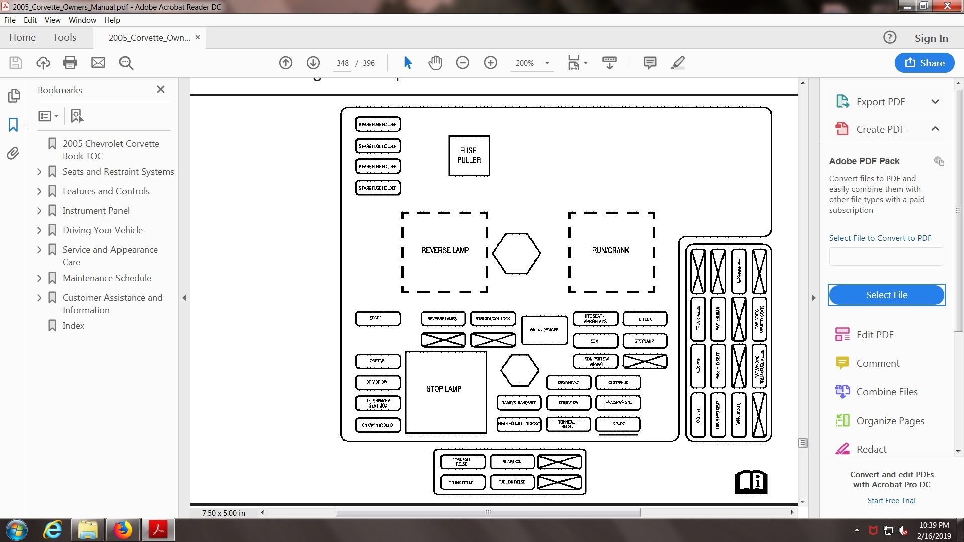

That diagram is on page 5-88 of the 2005 Owner's manual. Right hand side, 2nd fuse down from "RUN/CRANK". (See below)

Vette_DD.
I'm not sure which is more magical: The fact you gave an answer from the OM (which is downloadable for every year. ) or that I can only see the diagram on a reply to your post (not your actual post)?
eta: never mind, I see you edited it and add the diagram.

Originally Posted by owc6
Vette_DD.
I downloaded each year's owner's manual each year, so I had the 2005 owner's manual on my desktop computer. But I spent a few minutes looking at the 2 fuse box illustrations without finding anything labeled as being for the underhood lamp. Then, when C6ToGo provided the info. for which fuse it was, I edited my post.
I had 2 05s, an 06, an 08, and an 012, so several of the ower's manuals were downloaded for myself.
