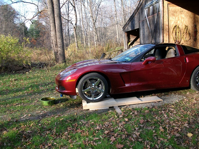

To just change the oil, I crawl under from the front. I'm 5'10" 180 pounds though, if you've got a big beer gut or something it might not work.
LOL @ that oil drain pan. It's a plastic wash basin I bought in the late '60s. They hadn't invented the modern drain pans yet.
