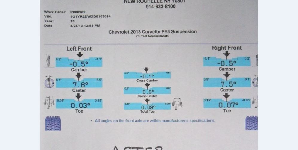

That's because the alignment was done wrong. A stock c6 alignment set to dead center of the factory specs yields tremendous handling and great even tire wear. I am on my 3rd c6 and never a wear problem on a tire. The problem with the factory settings is the tech doing the alignment, not the specs themselves! Like This

The factorry alginment specs allow for more toe in than the pdaft specs, a little bit more toe in and the negative camber (as much as -1 degrees) is more than enough to produce uneven wear on the inner front where you will have half the life of most manufacturer specifications.Combined for most alignment techs to just get it in the "green" for manufacturer settings rather than think of ideal settings vs consequences and you have a recipe for inner tire wear across more than a statistical anomaly would account for.
factory specs
front
camber -0.45 +/- 0.60 (+0.15 .. -1.05)
caster 7.90 +/- 0.60 ( 7.30 .. 8.50)
toe in 0.20 +/- 0.20 total ( 0.00 .. 0.40)
rear
camber -0.45 +/- 0.50 (-0.05 .. -0.95)
toe in 0.00 +/- 0.20 total (-0.20 .. +0.20)
So you have 1 tech at a GM doing fairly decent work to get it close to right?
The reason pdaft exists (who's done more extensive testing than just 3 vettes) and the complaints on this forum alone across 05-13 tend to indicate that the factory specs are not quite as robust as your experience would indicate.

So whats your point. You can throw out all your numbers and explanations why because setting the factory specs to dead center reveals the correct numbers for proper tire wear. I really don't know why everyone overthinks this and Pdfat this and that. Set the thing dead center and you need nothing else. BTW I think GM tested a little more than 3 vettes also.

Set your front Camber at -1.05° and the Toe at +0.40° (all within OEM specs) ... and you will eat up those front tires in less than 12,000 miles

GM specs are NOT the most ideal and if you follow the thought process of most alignment techs, getting it within spec doesn't mean jack alk as Turbo6ta has pointed out as well. You are taking this way too personally. I've had the gm specs for 2 of my vettes across 6 sets of tires. The last 2 sets laster longest with the tighter padft street performance specs which are ALSO within gm spec, but narrow the range to ensure tire wear and contact patch according to your driving style.
You aren't being constructive when you say just center it within gm specs. We are providing a proven combination to ensure ideal tire wear for other members, not anything crazy that requires anything more than showing a printed sheet to the tech doing the alignment

Exacty my point. When you set them dead center there is no guessing or numbers you have to plug in (aka Pdfat).

Yup .... and again, if you want great tire wear ... Set the Front Camber to -0.5 degrees ... Set the Rear Camber to -0.3 degrees ... and get both Front and Rear Toe as close to 0.0 degrees as you can
Simple
