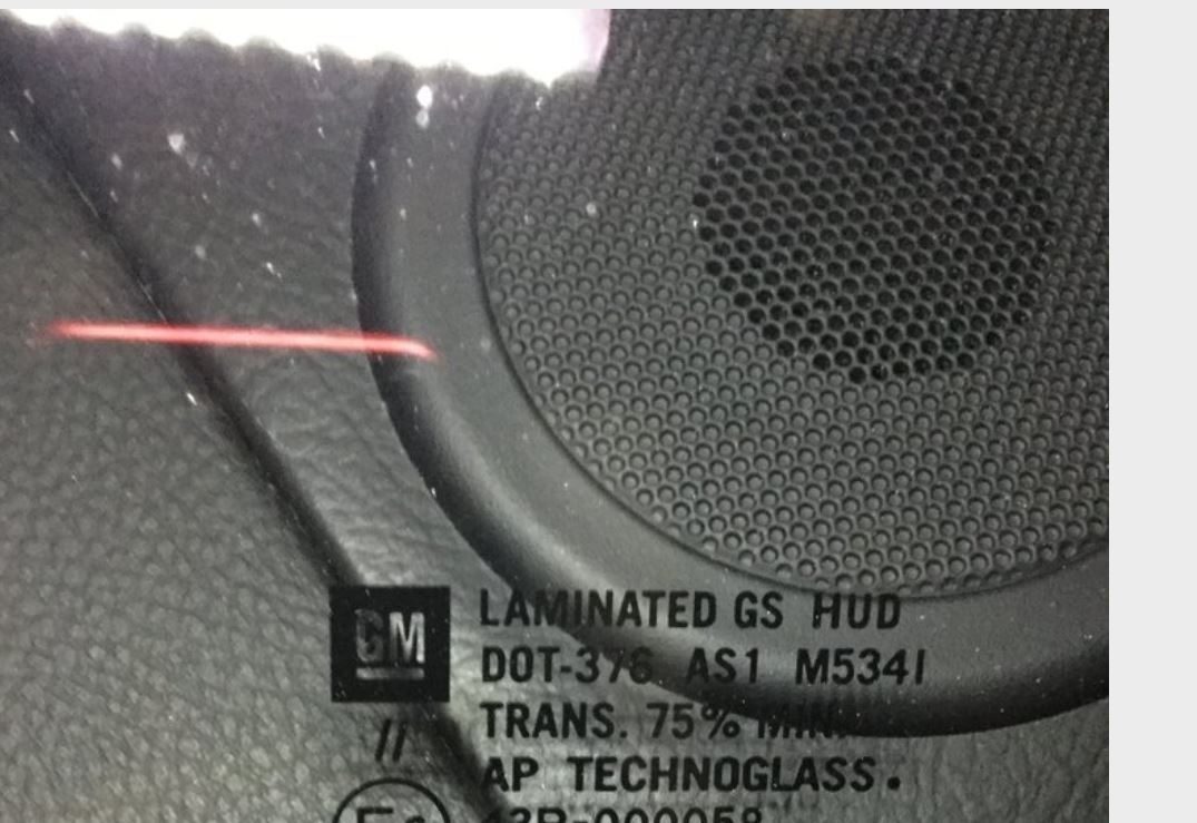

Safelite did mine on my"13 GS this is the info in the glass. I had it done in their shop per their request. The shop in my town does not like to do mobile on a vette. I was very pleased with the outcome. I was told that the manufacturer is the only one that gets the GM etching in their glass.

Ontime, you're the man posting that pic of a safelite HUD windshield! That it has DOT-376, the OEM GM glass supplier code, is awesome, just without the GM logo.Your pic encourages my thinking that by ensuring that the insurance co. is paying for the HUD glass, you'll get OE manufactured glass,
I'm totally OK with losing the logo, the OEM quality is what I'm looking for.

To follow up, Safelite did mine (HUD) today, and the new windshield was marked with manufacturer code DOT-376 (same as the original), which is the OE supplier, just no GM logo. Very happy with the result.
