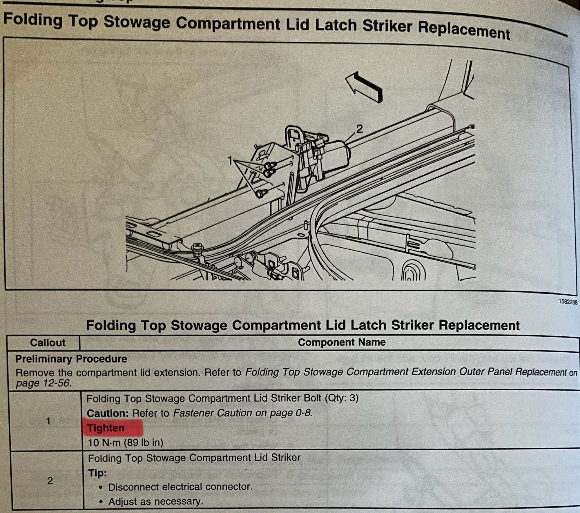

I would just like to know the torque spec for the three bolts that hold the motor on?

Thanks for the answer to my question on tightening the three bolts. I had to play it by ear and just snugged them up. I told the owner that on the average according to the guy doing the clips at Hydraulic Tops, her top's components could fail at any time due to age and the heat during our summers. I told her about the upgraded parts from Hydraulic Top and she plans on doing a total replacement soon. So, I guess everything I've learned from this little project will be used again whenever she gets the parts. Thanks to everyone for all their help. I've worked on equipment that ran at 34,000 rpms and mechanical seals that had seal faces that their flatness had to be measured with light bands but, never had I worked on a Corvette convertible top before. Hopefully the top will work until the new parts get in and I can replace them. Thanks again.
