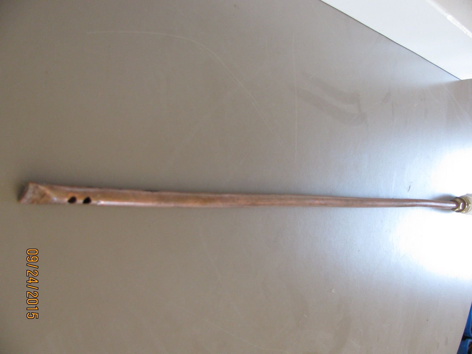

Remove the upper radiator support. Make a water wand with 3/8 copper tubing and fittings for a garden hose. Slide a piece of cardboard between the condenser and radiator and spray the radiator from the backside. Then insert the wand between the cardboard and the condenser and spray it out.
