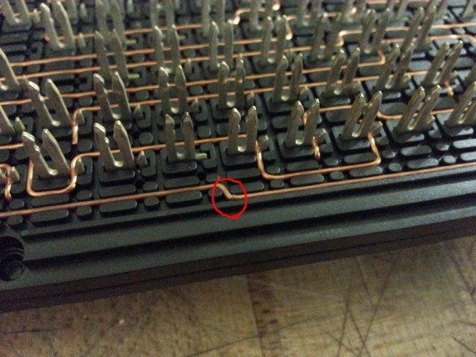

UBEC is GM-ese for fusebox. It's the plastic box on the passenger side of the engine compartment with all the fuses and relays.
Presumably they're referring to the recall for the low-beam malfunction, which is indeed caused by a flaw in the UBEC. However, GM's fix wasn't to replace the UBEC, but to install a wire to bypass it.

I have an 06 and I refuse to let the dealer do the recall. I have not had the low beam issue yet, and if I do, I'll do the fix myself.
The problem is a sharp turn in the ground wire for the low beam expands and contracts with heat and cold. Some wires break at the bend, and the engine bay heat makes the ground wire expand and the low beams quit working.
Here is the pic of that ground wire that has the break in it.
GM dealers simply install a bypass around the break.
