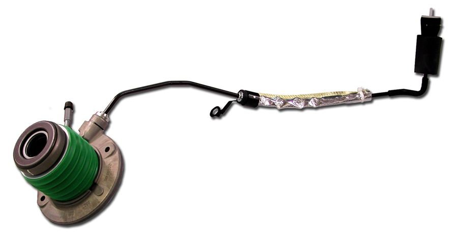

Originally Posted by icyshark
Can you provide me more details about the heat insulating wrap? Thank you!
The heat shield is the shiny sleeve that surrounds the flexible section of the hydraulic line from the master cylinder (not pictured) to the slave:
