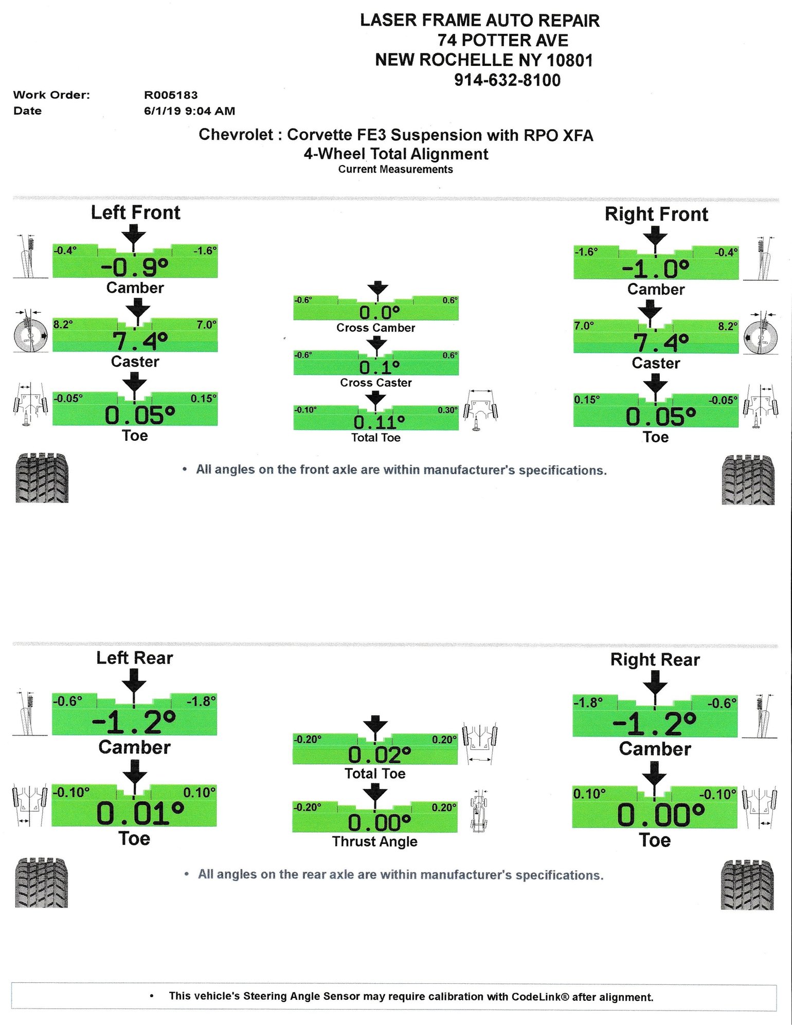

The dealer is going to use GM specs. If done correctly it will look like this. I have never had a problem with tire wear when the GM specs are set dead center. My guy is ocd when it comes to wheel alignments and always makes them perfect. I have been using these specs and this guy for 8 years.
