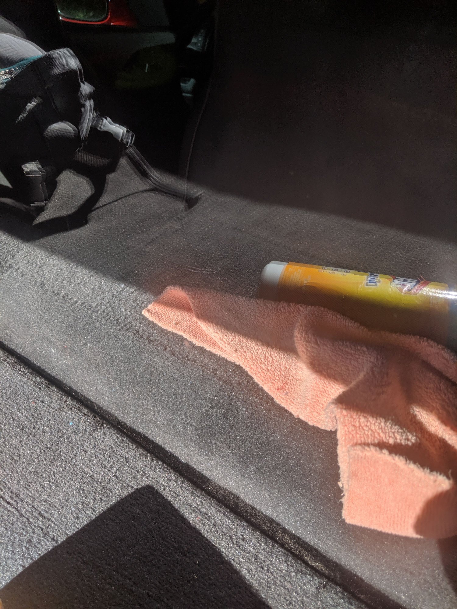

I don't know if any of you might want to try this, but I'm posting here just in case. I used to have a C5Z and after I installed a foam insert that separated the front part of the car from the trunk area, the car was much quieter. Not Lexus quiet, but noticeably quieter. Now I have a C6Z and there was no way to put in a similar foam divider, since it's a hatch design instead of the fixed roof coupe of the C5Z. I guess I could have stuck a foam divider in, but then I'd lose my rear view mirror, and that was a no-go for me. So what I came up with is a 1/4" Plexiglas divider that also make my car noticeably quieter than without it. To make it as noise blocking as possible, I put a 1/4" wide rubber U-channel around the upper part that contacts the plastic of the hatch hoop. I made the pattern by using a piece of cardboard that's 1/2 the width of the hoop opening, and doing a check/cut./check/cut routine until I was happy with the fitment. The bottom of the plexiglass fits right up against the ~3" wide ridge behind the seats, and I then forced the upper half into the hoop area, and the rubber edging has kept it in place now for going on 2 weeks, with no sign that it's moving.
BTW, I installed it vertically at first, but the reflections from the front of the car was making it too difficult to see when using the rear-view mirror at night. Basically, the car headlights and any other lights would show a reflection on the plexiglass such that using the rear-view was just too difficult.
The rubber edging and pushed into the hoop area.
Bottom of plexiglass that sits in the carpet channel behind the ~3 wide ledge behind seats
Pattern made from cardboard

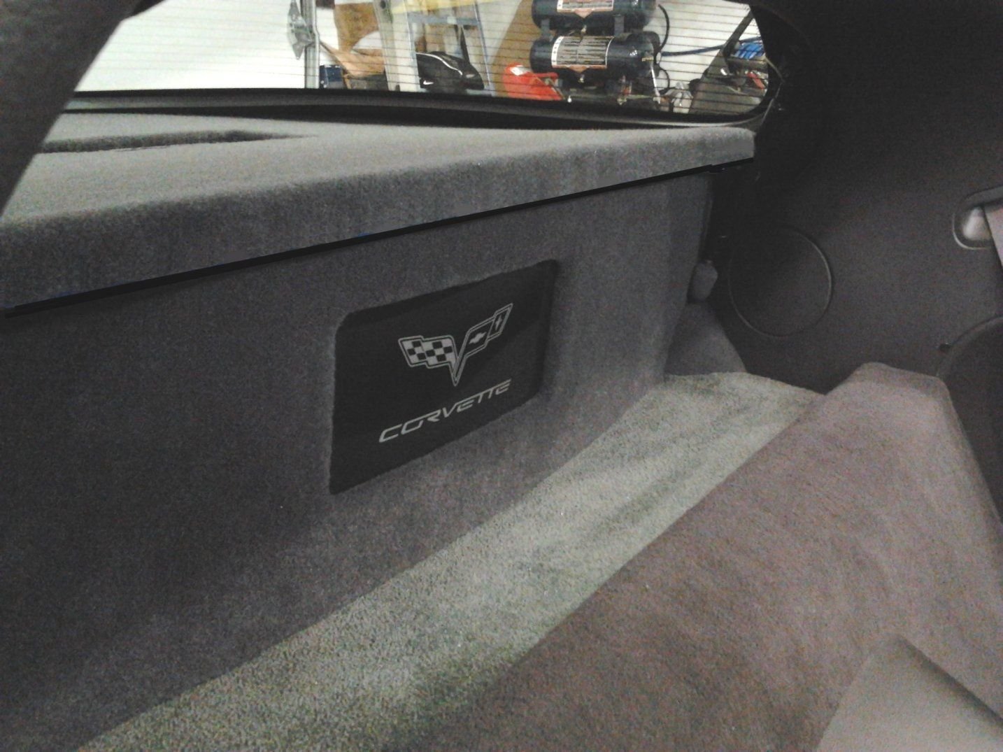

Yours is interesting, but this is what I did to separate the front from the rear hatch. The noise from the wheels and under the hatch area is trapped in the void made by the 2 partitions.
Both are made out of solid foam board covered with matching ebony carpet. still room under the hatch glass (top) partition to stow the removable roof.
