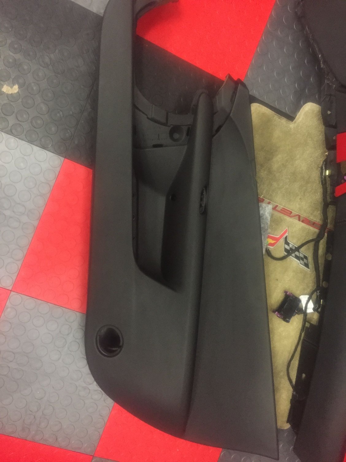

Hello all, can the door panels be taken apart? what i mean by this is could i separate the top, middle, and bottom after the panel is off the door, i'm talking about where the door panel seems the have separation lines? I'm asking to determine how to proceed with carbon overlaying involving the middle door panel section and as well as leather on the top. figured id as before taking the door apart.

Only the top and bottom separate. I covered my door panels with leather and had them apart.
http://www.theredlion.us/DSV%20Drive...%20Install.pdf
http://www.theredlion.us/DSV%20Passe...%20Install.pdf
Once you remove the panels and handles, there are screws and crimps holding the two pieces together.
