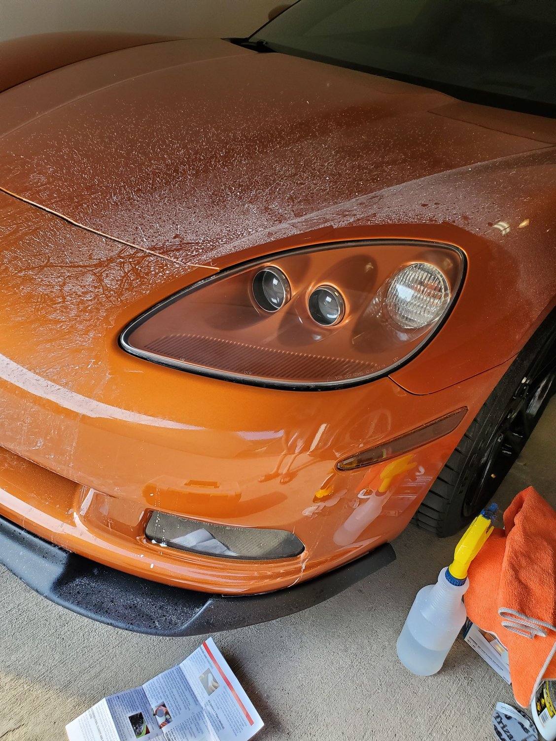

I knew my lights were crazed and was worried it was internally. Thankfully it was the clear coat, and these have turned out great so far. I'm waiting on some buffing pads to come in to finish SO THIS IS STILL A WORK IN PROGRESS, JUST AFTER DAY 1, but if your lights are CRAZED and you don't want to replace the lens, just know the sanding method will likely work. I plan on using some spraymax 2k to clear them, and buff that out too. I was pretty nervous doing this too.
I used 3" Velcro pads attached to my drill and worked my way from 180/240/400/600/800/1000/1200/2000/3000/ rubbing compound by hand and then I'm going to mechanically polish soon. And yes wet sanded too every layer.
240 grit
180 grit
I think 1k grit?
2k grit
3k
Hand polish
Passenger side before
After hand polish

Buffing pads came in, I buffed and cleared and man the driver side looks great!

Passenger side...

I decided against the 2k after reading how hazardous it is. 3m makes a clear coat wipe that actually worked a LOT better than I thought.
Originally Posted by 2008 Corvette
Question. For a $2.50 plastic drop cloth why didn’t’ you cover the rest of the car. The lenses do look good however, nice job.
Yeah, I don't know. Will get one for the next side tho
I guess I figured it's just water spots and I was gonna rinse it after so I wasn't too worried considering I'd needed to wax it soon anyway. She's sat outside the last 2 years so being in a garage she's getting pampered..

I'm convinced though sanding is the way to go vs pulling the lights. I was 1000% convinced the crazing was on the inside of the lights and I feel like anyone can shine theirs up too with some good ol fashion elbow grease.. I was way too scared to take them off, put em in the oven etc.
