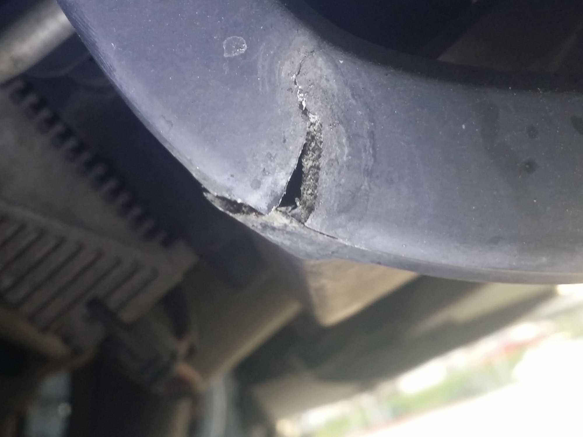

I hit a pothole like 3 years ago and never really looked at it due to the fact that nothing was wrong with the car. Didn't have any leaks any issues anything like that.
I know this is cracked. I guess my million dollar question is where it is cracked is that part of the frame?

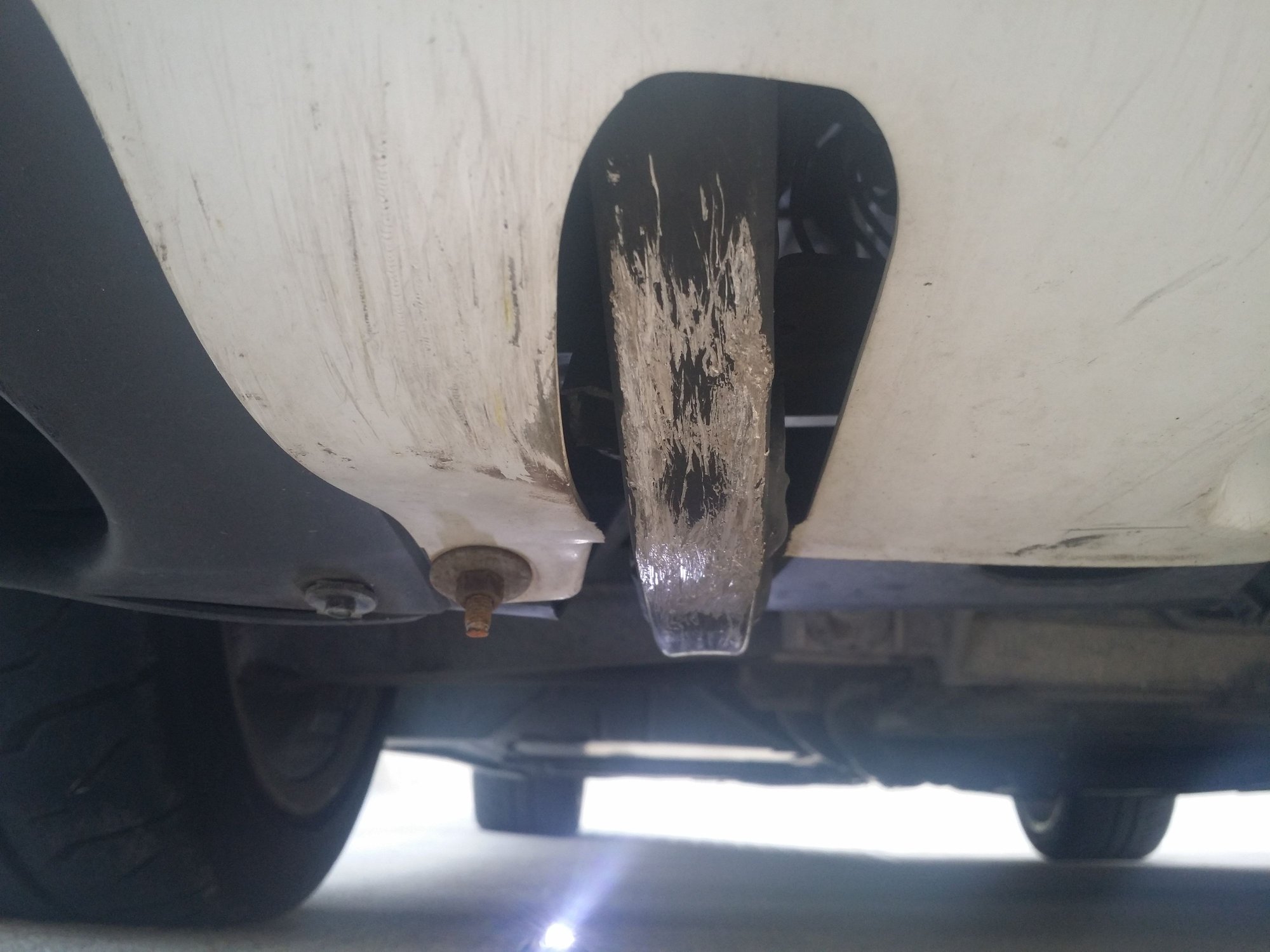

If you look at the 3rd picture its scraped on the front side and then it goes up towards the motor and its cracked on the back end.

Radiator support bracket. Most just have it welded. Do a forum search on radiator support bracket for complete discussion on options.

Yes, it is the radiator support bracket. It's not too difficult to replace, the only problem is that it is aluminum and will bend or break again if you are not careful. There are some protective skid plates that you can buy to put over it but they will do no good if they take a big hit like yours did. Here is what it looks like new.

This happened to me. Broke all the way through. part was around $400.00. Install was another $200.00

Like the others have said, that is not frame damage but simply the radiator support

Easy repair, you just need something to hold up the radiator when you remove the support. I also had mind powder-coated black. I use some homemade ramps to get a little extra room under the car.
If you change it, make sure about the nut inserts. This is the one I used.
