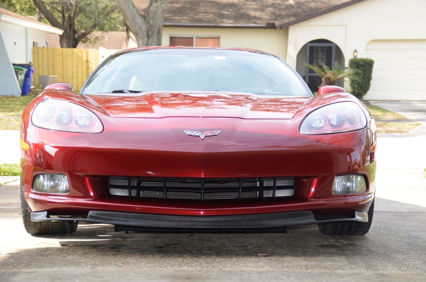

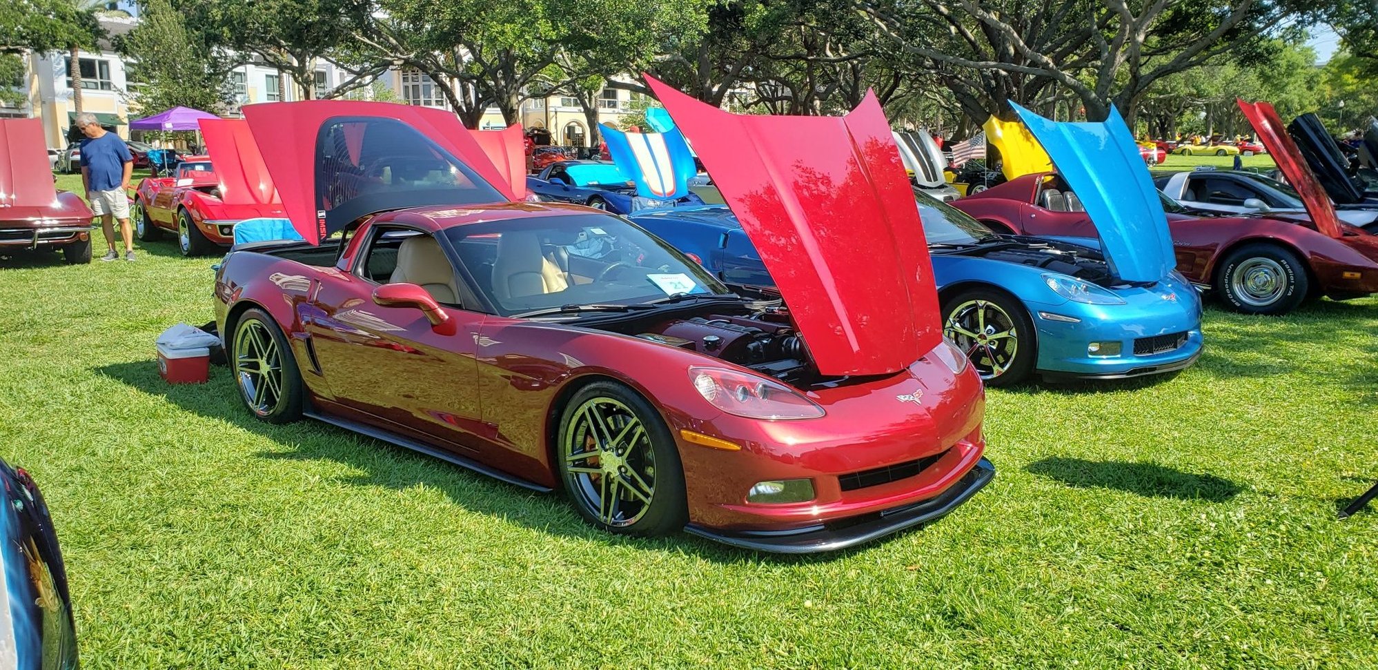

I am assuming you ordered the ZR1 style splitter for a base, not just a ZR1 splitter. If you did not order for the base model it will never fit. I ordered one along with the side skirts and spoiler. The splitter never looked right so removed it. But as far as mounting, I of course had the car up on jack stands, and I removed the two outer pieces of the stock air dam. I then took two jack stands and placed them on each side of the car and had a 1x4 placed on them to support the splitter. I attached the splitter using one of the bolts that held the air dam to the outer point that the air dam was attached to. Then did the same on the other side. Once it was attached to the outside attachment points I then lined it up with the bumper and with self tapping screws I started in the middle and then worked both ways. While it was attached it just did not look right it seemed bent or warped. I ended up ordering one from RPI Design and used the same method to attach it and it looks fine.
While the splitter did not fit correctly, I had no issue with the side skirts and spoiler. I am sure that if I had contacted EOS we could have worked something out. Also After installing the new splitter from RPI, I then ordered a replacement set of side skirts from EOS that they had in the hydrocarbon look to match the front splitter.
RPI Design Splitter
