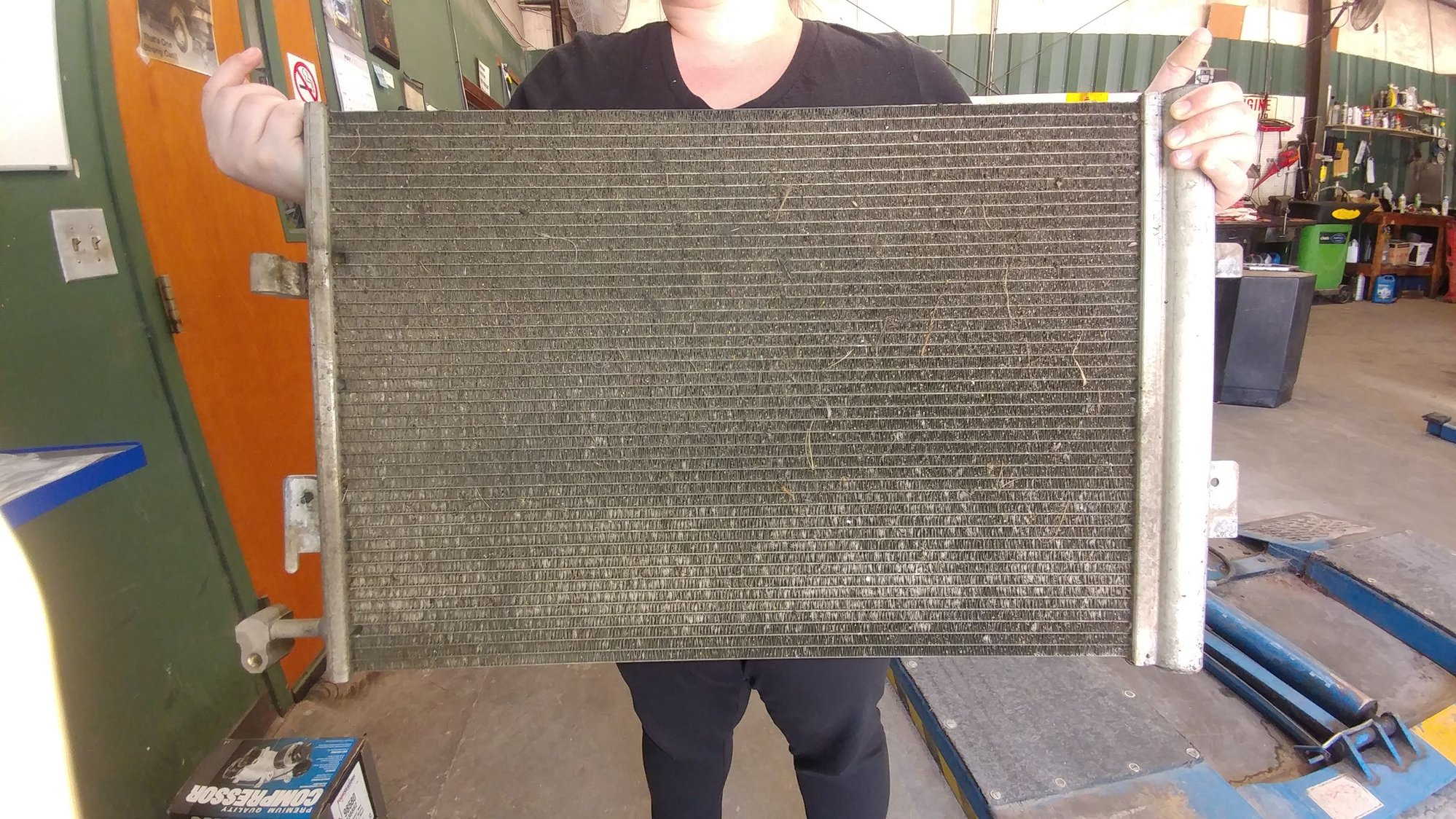

My 2005 had A/C problems. One issue was a factory coolant overcharge but what ultimately ended up being the biggest culprit was the condenser coils were so jammed up with road debris that it was barely passing air. It was so bad that my engine coolant temps were elevated as a result because the condenser sits in front of the radiator up front. I had the condenser replaced, new inline filter, and new compressor all done in one shot and now it runs flawlessly all the time no matter how hot it is.
Before: intermittent AC that was constantly cycling on/off when it was above 85 deg F outside and coolant temps that got as high as 235.
After: rock solid AC that never cycles off even in 100+ deg southeastern summer days and my coolant temp is usually about 200.
Photo of just how bad it was. This was AFTER debris had fallen off of it once after it was removed.
No wonder my AC performance was awful and my coolant was running hot.
