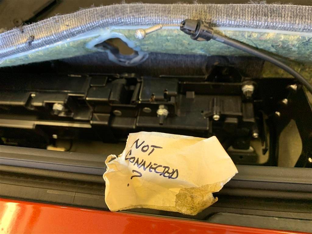

So we opened up the back area and discovered the hatch key cable is not connected to anything and has a tag on it saying Not Connected.
I am told that there should be a level on the hatch control module that the cable connected to but I do not see anything to connect it to.
I bought this car new and took Museum Delivery in Bowling Green. Car has never been in an accident and this area has never been opened up. I have to believe it came out of the factory this way.
Anyone has a picture of the way their hatch key cable attaches in their C6 Coupe?
Thanks.
Tag found connected to hatch cable

theres supposed to be a plastic pull lever above that radio receiver on the right side of your picture. the little metal claw above it holds the plastic tab.

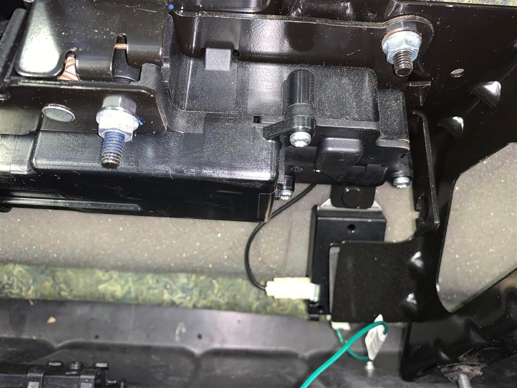

I hate to be dense but can you circle for me the radio receiver and where the claw is? Clearly that plastic lever is missing and I am trying to figure out if I can hack something together.

Is the piece circled in red the plastic pull lever my mechanism is missing? This looks like where the cable goes into.
To Hatch Key will Not Open

It should look like this when the cable is in place

Sorry, i just logged back in - aj and 4summers got it though. I honestly do not recomend taking apart that box - I did, it was a PAIN - I had to drill out a few aluminum crush bolts and the inside was quite complex. If you can see the tab itself though and its just slightly broken you might be able to glue/rivet somethign on to make it work.

Thanks Mike. It looks like the tab the box was defective from the factory with no sign of the pull tab in the slot on the box. I ordered this to replace it ...
https://www.smcautoparts.com/2278241...345-exx008.htm
