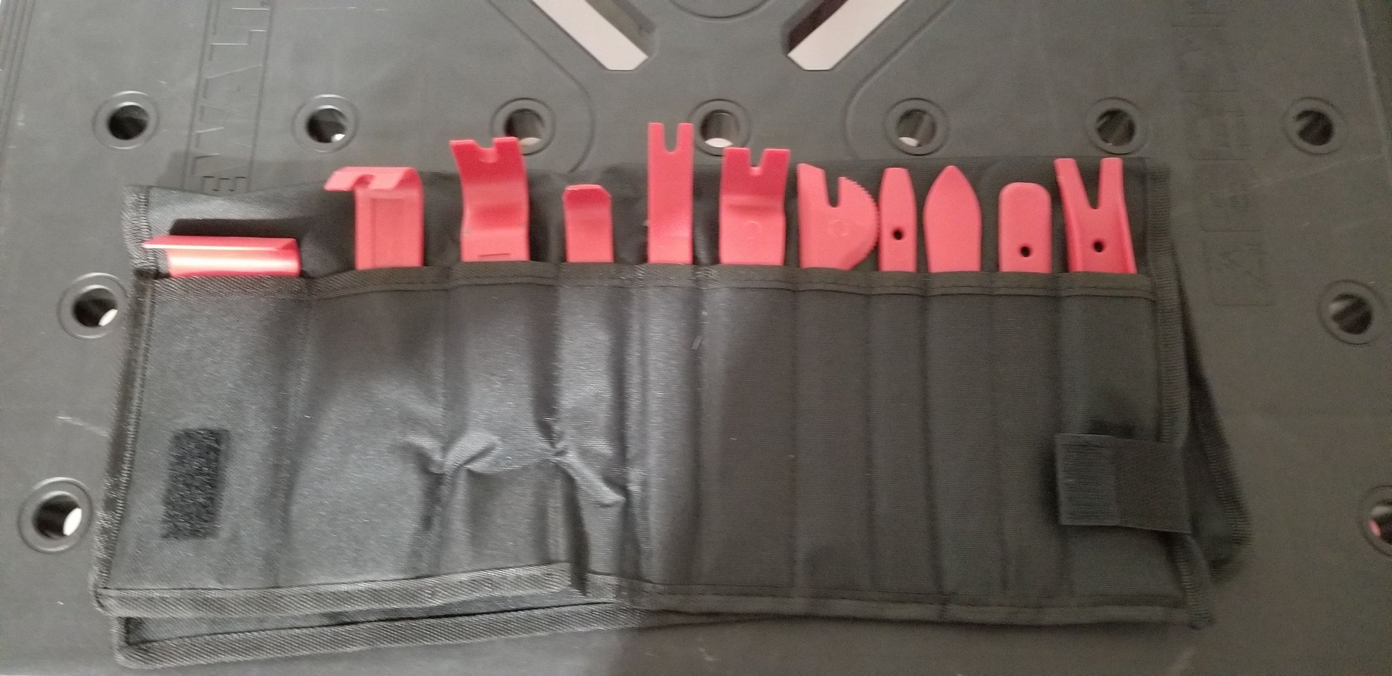

Tools for the project
Trim removal tools

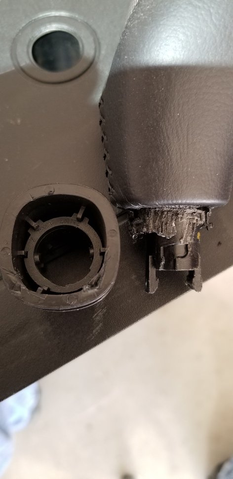

  1. Removing the automatic **** handle and the center console. This has to go down as one of the worst tasks I have ever had to do on any car(shifter ****). It is outrageous that GM designed the shifter in a way that you nearly break the shifter to remove the ****.

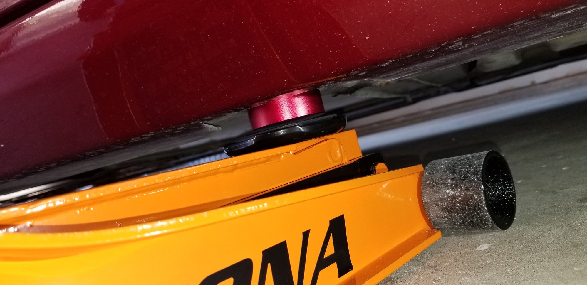

  1. Jacking up the car
I purchased some jack pucks and a new Daytona floor jack from Harbor freight. I also purchased two cinder blocks.
Jacking Pucks
[url=https://www.amazon.com/gp/product/B07L4L5JPW/ref=ppx_yo_dt_b_search_asin_title?ie=UTF 8&psc=1]
Amazon Amazon
Daytona jack
https://www.harborfreight.com/3-ton-...nge-64200.html
Installing the pucks into the slots was easy. I used the floor jack and started jacking the car up very slowly with the puck in the slot behind the driver side door. This essentially lifted up one whole side of the car. I placed the first jack under the front of the car on the crossmember behind the oil pan. Because the jack stands are not perfectly flat you have to find the right spot on the crossmember to place the jack. I spent time under the front of the car looking for the perfect spot to place it.
I then went to the passenger side of the car and did the same thing.
Next was the rear of the car. I placed a piece of wood on top of the floor jack and jacked up the rear under the appropriate space. It easily lifted up the rear of the car. I then placed the jack stands in the appropriate place. Again finding a nice flat spot for the jack stands is a challenge. Frankly after I had the car jacked up I still never felt completely safe getting under it. I placed two cinder blocks on each side of the car where the jack puck would go for extra insurance. In addition, I left the floor jack under the rear of the car with just a little weight from the car on it.
After all was said and done I was able to lift the car 14 inches into the air while on jack stands. I simply didn't feel comfortable jacking it any higher than that. I had two sets of jack stands-one Torin 3 ton and another Craftsman 3 ton. They were both new and the Craftsman 3 ton had a very poor build quality versus the Torin 3 ton. After this project was finished I bought another set of Torin 3 tons that have a pin for additional safety and some rubber caps for the jack stands..

The following video helped a great deal with removing the center console. I also highly suggest plastic trim removers rather than a screwdriver
The video was very accurate when it came to removing the console. Once I had it removed I noticed that the four bolts that hold the shifter in had been removed. I thought right away that either the plastic bushings in the auto shifter cable had been replaced at one point or the cable itself had been replaced. Nevertheless I proceeded to cut the black plastic retainer with a small hacksaw to prevent the auto shifter lock in park problem from ever raising its ugly head.
Removing the shifter **** was hell. I watched every video and read every post about it and it still didnt help. It simply was stuck on. Removing the auto shift **** was the combination of twisting, pulling and turning with a assist from vice grips to get off. It was so difficult that at one point I thought I was going to have to give up on the project. But with a twist of the vice grips and turning it finally came off after about 45 minutes. Be warned-this is the toughest part of this whole project.

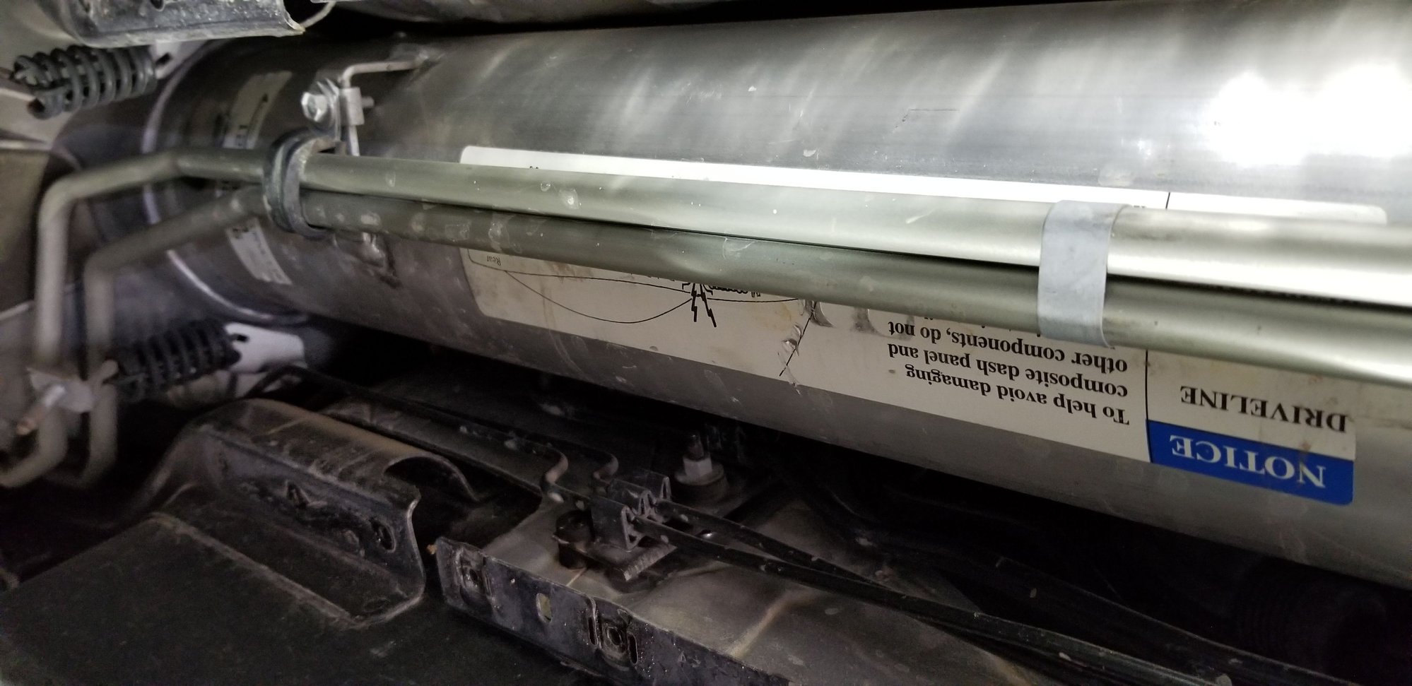

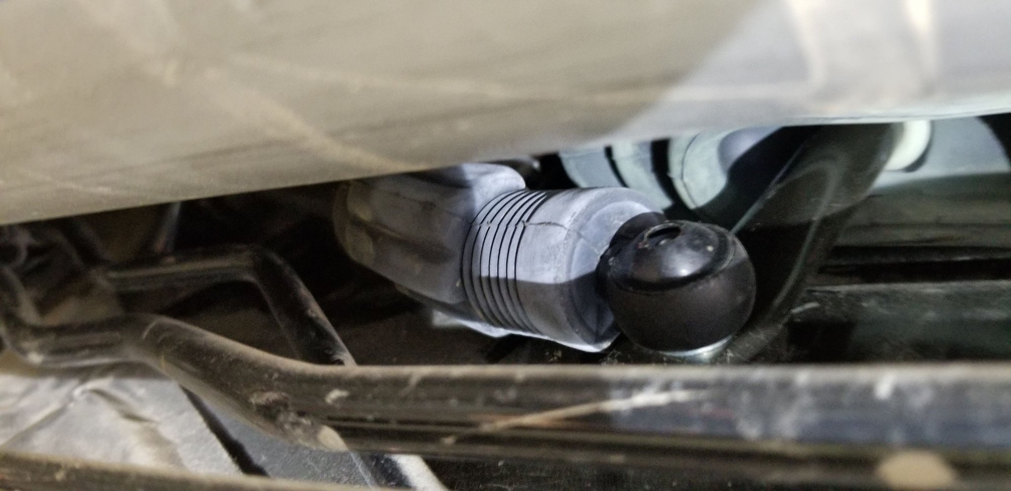

  1. Torque tube and the cable
After I removed the torque tube cover I saw the infamous torque tube. I say infamous because I have read all of the stories about the horror of these needing replacing or maintenance. I then began to fiddle with the auto cable getting ready to replace it and noticed that the cable looked relatively new. I bought a very bright headlamp and it really illuminated the bottom of the car ([url=https://www.amazon.com/gp/product/B014JUMTXM/ref=ppx_yo_dt_b_search_asin_title?ie=UTF 8&psc=1]
Amazon Amazon
). I popped the shifter end of the cable off and looked at the plastic grommet and saw it was clearly new. I then slid to the back of the car where the cable attached to the transmission and saw it was new as well. In fact it looked as new as the replacement cable I bought from the GM dealer. So it became clear to me that the four shifter bolts I saw that have been removed at some point were removed because the cable had been replaced. As a result I didn't not replace the cable.
I was actually happy as my arms were killing me along with my back. Having only 14 inches of lift from the jack stands was enough but it is very tiring being under the car even with a rug on the ground.

Great job and great instructions. The one question I have, is why did you remove the shifter ****? You could simply just lift the leather boot as high as it goes around the ****. I have removed the shifter ****, and it is not an easy task. There is a knack to it for sure.

Great post! I agree the A-6 shifter is the worst design I have ever encountered. I have had it off several times and found if you lightly lube the attachment shaft with white grease it makes it much easer to remove it again if ever needed.

I too don't understand why you removed the A6 shifter **** ... removing the 4 shifter mount nuts, and the shifter just pulls straight out (after the cable is disconnected from the shifter)

I removed the shifter **** because I wanted to. I wanted to see how difficult it was in an effort to learn. In addition I replaced the cable because there are so many instances of automatic C6 Corvettes having this problem. I enjoy working on the car so it wasn't a problem. I don't think I would just replace the bushings. If you got a high-mileage car I would just replace the cable.
