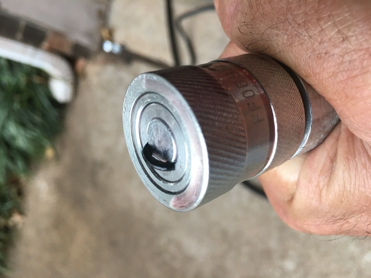

Anybody got a line on where to order parts other than the factory? Bought a bl5000 last Sept and it spit a o-ring out of the female hose connector and pukes fluid everywhere. I been on the phone 3 times for a hour and a half and there system won’t for whatever reason accept my info that thousands of retailers have. They said go to Auto-Zone they can order, they never heard of them or the part #. Basically just said sorry. I haven’t been this mad in years.

Thanks Which fitting did you order? They told me they had new updated female fittings part # 5550308 that work better than the ones I have. That number is not on Quickjacks website that I can see. I am out of warranty and they wanted 79 dollars for a 2 pack of the fittings. No problem just send them. That’s when the fun started.
They have run my card 4 times so far which I get as text messages on my phone but their system won’t complete the transaction. There doesn’t seem to be a problem on my end every thing matches and the card is good. I have lived and used the same card for over 30 years. It works everywhere else. its the only one I have.
I’m trying to finish installing new leaf spring jacking pucks and need to make 1 more height adjustment before I take it have it aligned.

Dutch it’s a o-ring on the inside of the female connector. I’m not sure if it’s serviceable. I’ll try looking again in the morning I’m still so mad I can’t see straight.

Is this what you are looking for?
Quickjack Hose Fitting set
I had a problem with one of the short hoses and they sent me a replacement for free because I was inside the warranty period.
If you are out of warranty, you may need to order the part.

stingray71 ^^^^ is your best bet, but I think you've tried them. Perhaps here at Amazon ...
