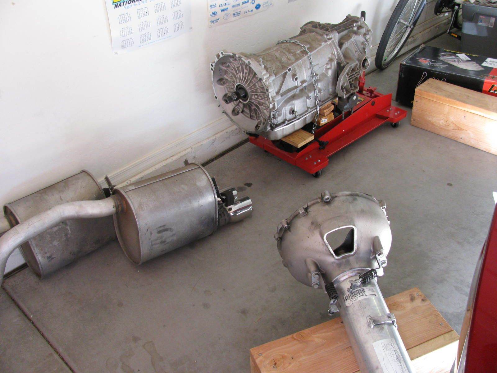

It's just sawing off the base muffler and welding in the bi-mode in the same place. With the exception of the extra weld (see the pic) and the lack of perforations in the tips, if using '06-'10 Z06 mufflers, it looks like the factory NPP option, since the pipes are all 2.5" dia.
Oops! Upon seeing my own pic, I needed to make the correction in the procedure on post #6.
Sorry about my memory lapse.
