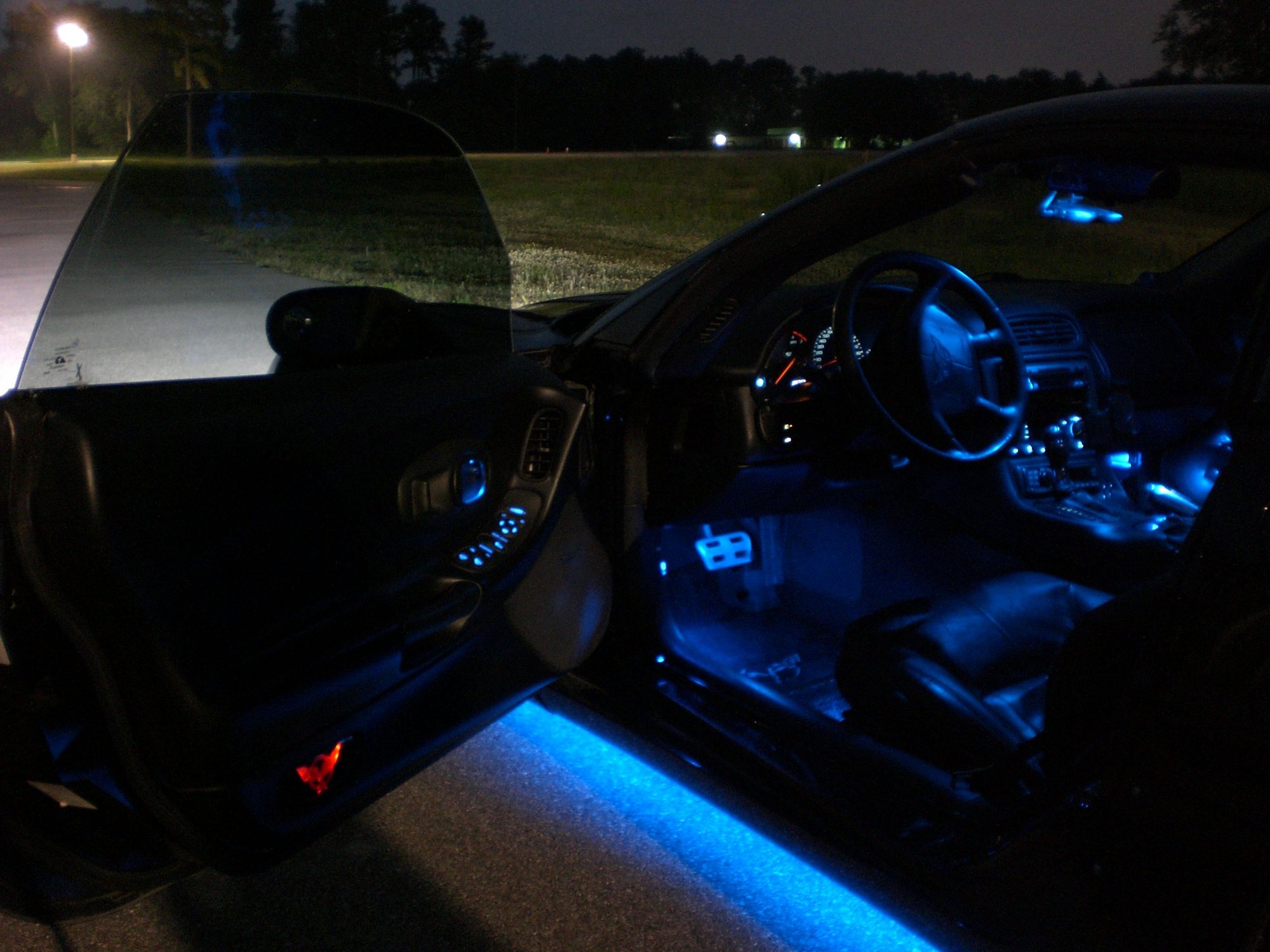

The challenge is that just about everything is going to be too bright. To get things the appropriate brightness, there are a couple of options:
A) take an inherently dim LED strip (like one of the older styles) and dim it down with a load resistor from a 12v as needed. (This is the cheap, but easy way....see below what I did with my C5)
B) get acrylic tubes with LEDs on each side notching the tubes with a Dremel at various points. (This is the more professional, but more difficult route...Something I've Never attempted)
