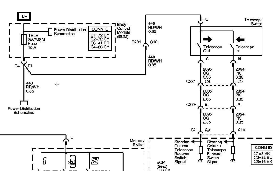

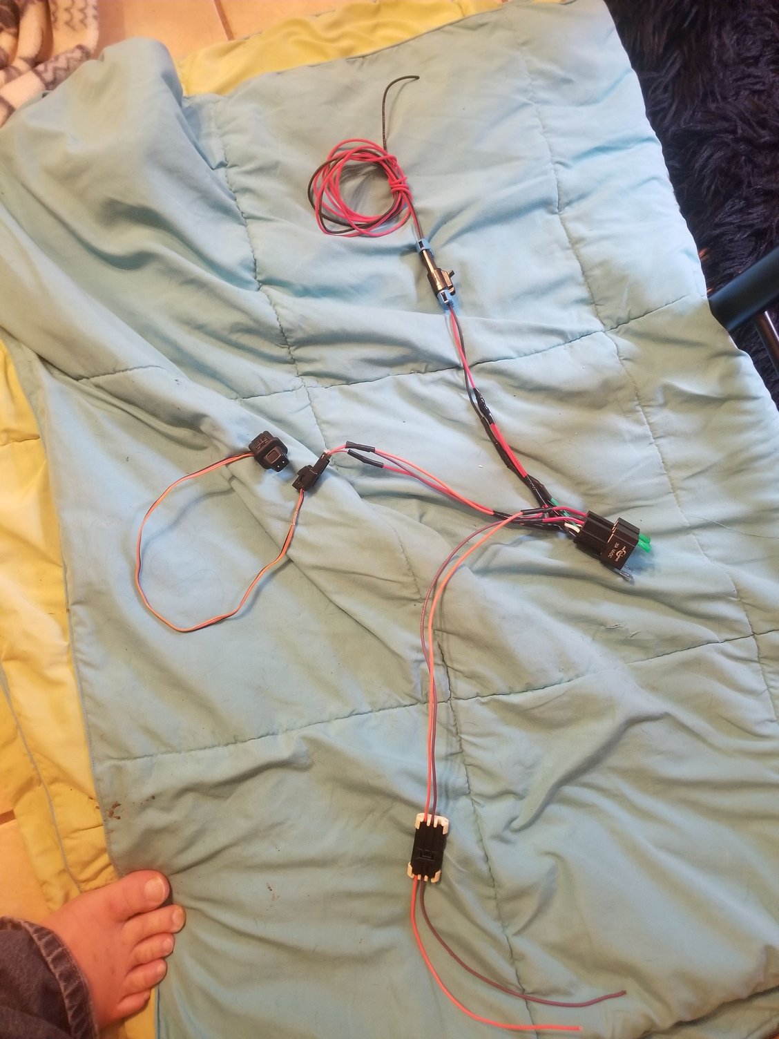

OK, here's my version of Dave's circuit. BTW, Dave, thanks a million for that schematic. I was scratching my head for ten minutes trying to figure out how to wire the motor because normally you bring power in through the #30 terminal and distribute it through 87 or 87a, depending on whether you want normally on or normally off. I finally got off my butt and looked at your drawing again. D'oh! (_8(|) Wire the motor to the #30 terminals and you can run the circuit in two directions depending on which solenoid is energized! That's what I get for soldering at 2 a.m., I guess.

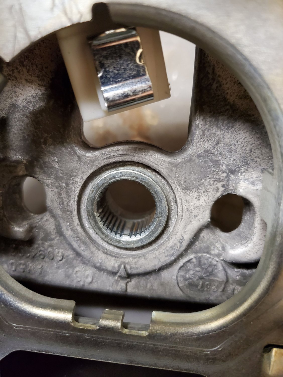

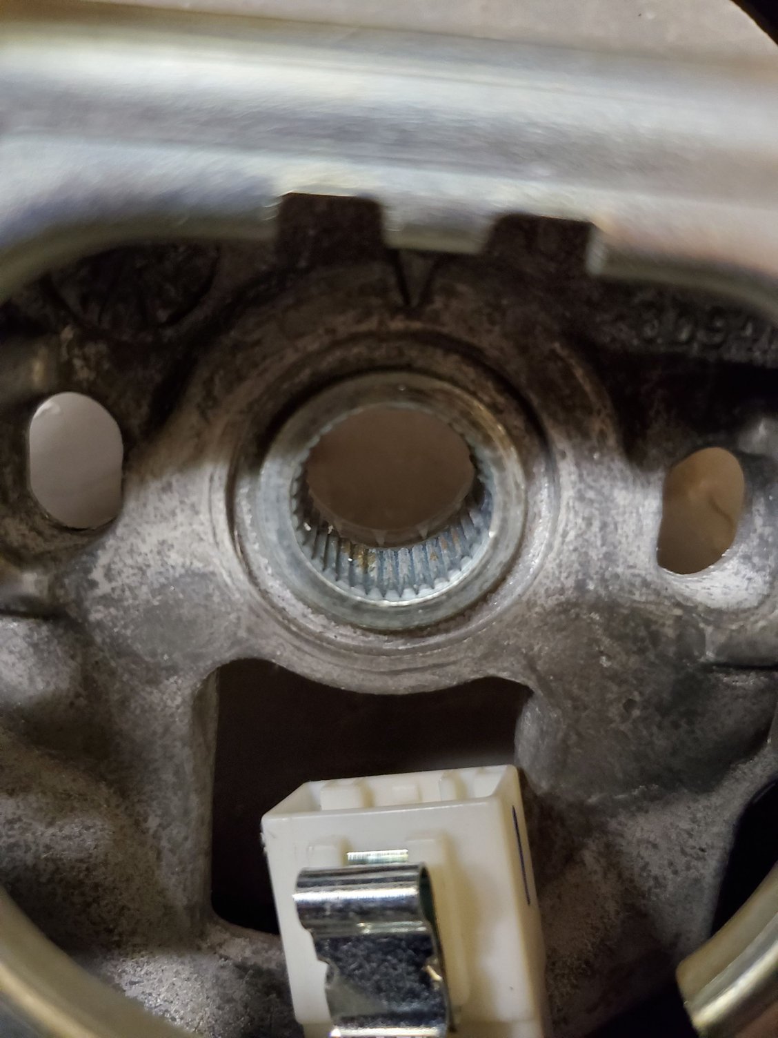

The steering wheel does not have a keyway in the strick sense of the word , what looks to be a key way is not really one and you can pull it off and move it one tooth either way if my memory serves me correctly as I put more than a few on have him try it but u need to make sure the shaft and sensor are reading center
Below is a picture of one of the wheels I pulled off of my buddies C6
