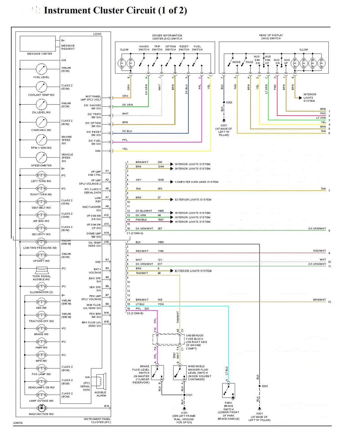

Personally, I would be checking the simple things first:
Will the fan start if jumpered?
1) Check the fuse for the radiator fan
2) Check the fan connector. These have been known to melt the power wire at the connector.

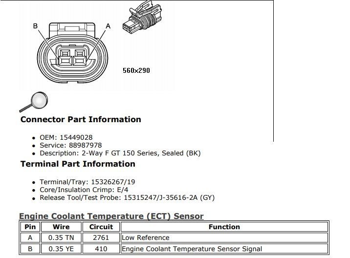

3) Engine Coolant temp sensor could be erratic or bad ( behind alternator on the left cylinder head) or it could be a broken wire t the connector.
Instrument panel
All the readings to the I/P is fed through the ECM behind the passenger fender wheelhouse.
The HUD speed VSS input also comes from the same ECM, but is a separate plug connector to the HUD
All those inputs from the ECM to the instrument panel are with a plug connector.

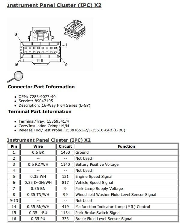

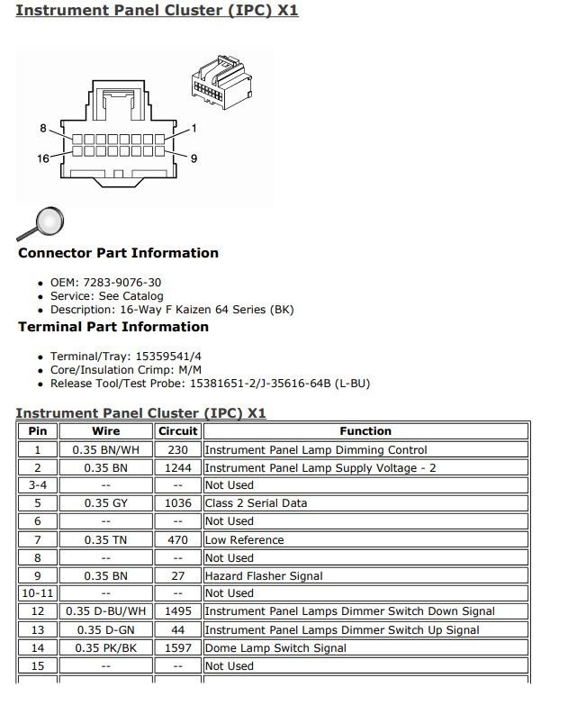

Have you checked whether the connector is loose behind the Instrument panel?
These are the Instrument panel connectors
