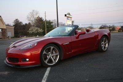

Not sure as mine was already installed when I purchased my 2012 GS, but I believe this is an EOS (Extreme Online Store) Zr1 type splitter. Perfect fit and good quality, I've bumped into a parking block or two without it cracking.
