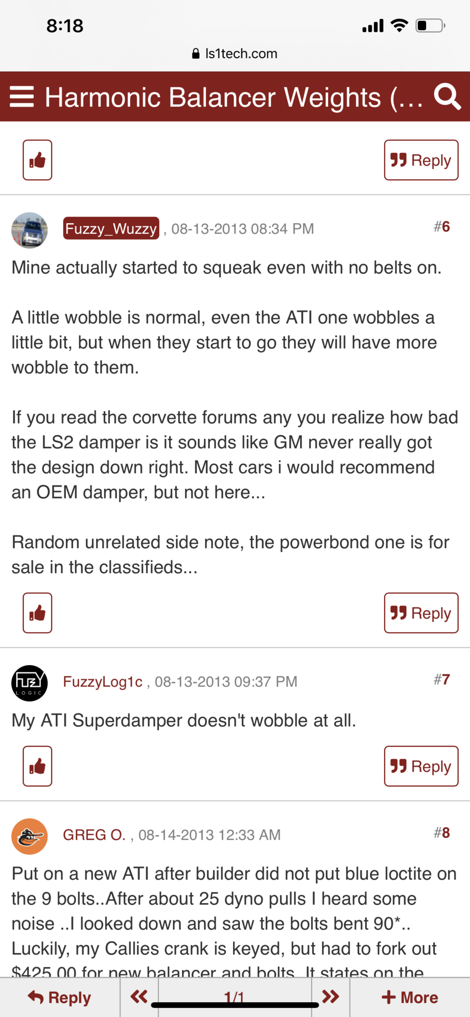

Been chasing a squeaky screech that’s most pronounced at 1800 Rpm thru 2000 Rpm. Changed tensioners, pulleys, belts, alternator bearing.
Today I ran car with NO BELTS at all. Just down the block and right back before water temps got up.
The same squeal screechy pulley sounds was STILL there and only thing turning is main crank pulley without belts.
as I look NOT a clear wobble unless I’m staring at center bolt and if I stare just at center bolt it’s jumping all around. Pulley itself does not appear to wobble.
is this clear cut Harmonic Balancer ?? 2006 Z06 with 31k miles.

Wasn't / isn't the infamous squealing / chirping caused by the belt rubbing against the edge of the balancer thus meaning that it would stop chirping if you ran it without the belt ??......whats missing ?....

When you say no belts, do you mean you also removed the air conditioner belt?
If you had no belts on the car and you are still getting a noise, then it is not the HB or a pulley. And when looking at the HB turning, you want to look at the grooves the belt runs in. If they don't have any lateral movement then the HB is probably good.

‘Manual, removed BOTH belts and drove about 3 blocks and same ‘external’ squeal noise at 1800 rpm-2k under load.

Balancer itself looks to be tracking straight BUT looking at center BOLT it looks like it’s jumping all over the place

So, I’m thinking there are a lot of people who do not actually remove both belts and drive around and to still hear the HB chirping/squealing.
Mine is pronounced at 1800-2000rpm but can faintly hear a rubber/metallic dragging noise ever so slightly throughout the Rpm’s.
its definitely an external noise associated with a pulley.
New HB Powerbond Race Version and ARP bolt going in within the week.
