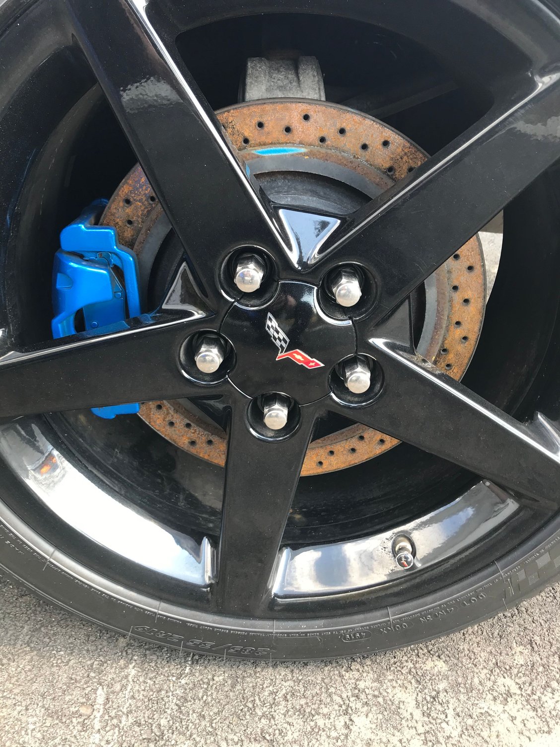

Hey all
What can I do about this rust, if anything?[img]blob:https://www.corvetteforum.com/5576eb29-a3a7-4756-bffa-a3cf7e8bbadd[/img]

That rust will be gone the 1st time that you use the brakes

Originally Posted by koolkats103
Hey all
Drive it.
Don't store it outside.
The rotor hat can be lightly sanded and painted with BBQ black.

Step 1: Drive car.
Step 2: Apply Brake.
Old Feb 28, 2020 | 03:56 PM

Black wheels make the rotor rust more !!!!

Originally Posted by 919cw313
Drive it.
No choice. Going to store in a Rhino canvas portable garage. Completely enclosed and zipped up. No choice...........

ZINC PLATED Rotors........................

Rust will disappear only where the pads contact the rotor.
Most have their rotors powder coated, or you can try to paint them yourself. Of course this means you will have to remove them which is not a difficult job.
