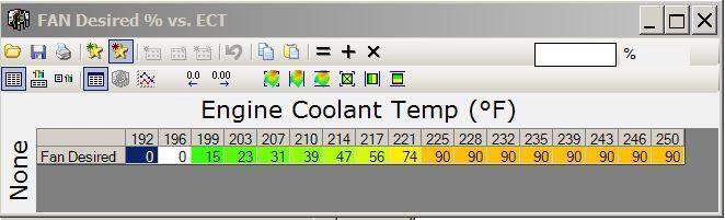

Here is the stock fan table.
Temps up to 225 are to be expected with an unobstructed rad when there is no air flow (i.e stuck in traffic, idling for extended periods). There is also some interaction with the AC system that causes the fan to ramp up sooner if pressure in the AC reaches a certain point.
At 221 and above, you should hear the fan roaring away. As others have said, your temps are fine. GM designed it to work this way.
You might have a slight leak if you smell coolant. But, if you only smell it sometimes when you are in traffic, you might be smelling someone else's coolant leak. I've got a pretty sensitive nose, and I sometimes smell coolant in whatever car I'm driving, but it disappears as the cars in front of me move on or away, so I figure it's their car and not mine.
That is great info. Thank you.. . Its very possible I'm being hyper sensitive. Just did the Headers, Xpipe etc. Now I keep sticking my head in the engine bay, lol... I'll keep looking to see if there is seepage or something...
